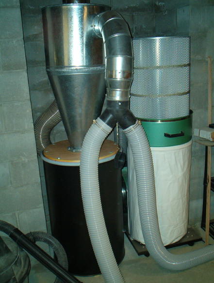

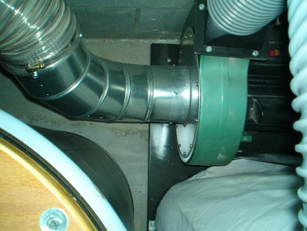

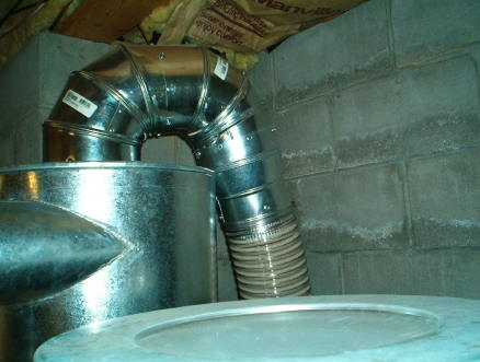

                          I built-out a HF 2hp DC system with a Wynns canistor filter, cyclone (mentioned above (ebay)) and Oneida 6" inlet upgrade to the DC. I mounted the cyclone to a steel barrel as can be seen in the attached photos. The system has/is working out very well. Its actually a little over kill for what I need right now, but once I got started on its design I had to do-it-right!
                            Now, that, is a dust collection system! I'm very impressed.
                            Do you have plans for a hoist or suspension rig for the cyclone so you can empty the barrel
                            or have you not filled it for the first time as of yet?
                            • SplinterHead
                              • 130
                              • Omaha, NE, USA.
                              I need the exercise!
                              The cyclone's out-feed is attached with flexible hose and the cyclone's in-feed ductwork is fully adjustable. All I need to do is loosen the barrel's rim bolt and the whole cyclone/plate assembly removes and is set on the floor so the barrel can be emptied (that is, when it gets half-full "for the first time"). I plan on mounting the barrel to castors or use a furniture dolly etc. to help move the barrel. As a whole, the system is designed to have mass for stability, but when broken down, it's really very manageable!
