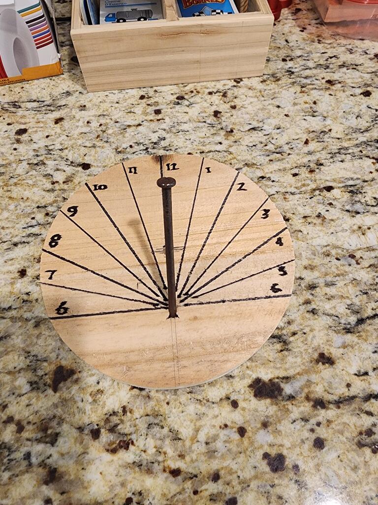

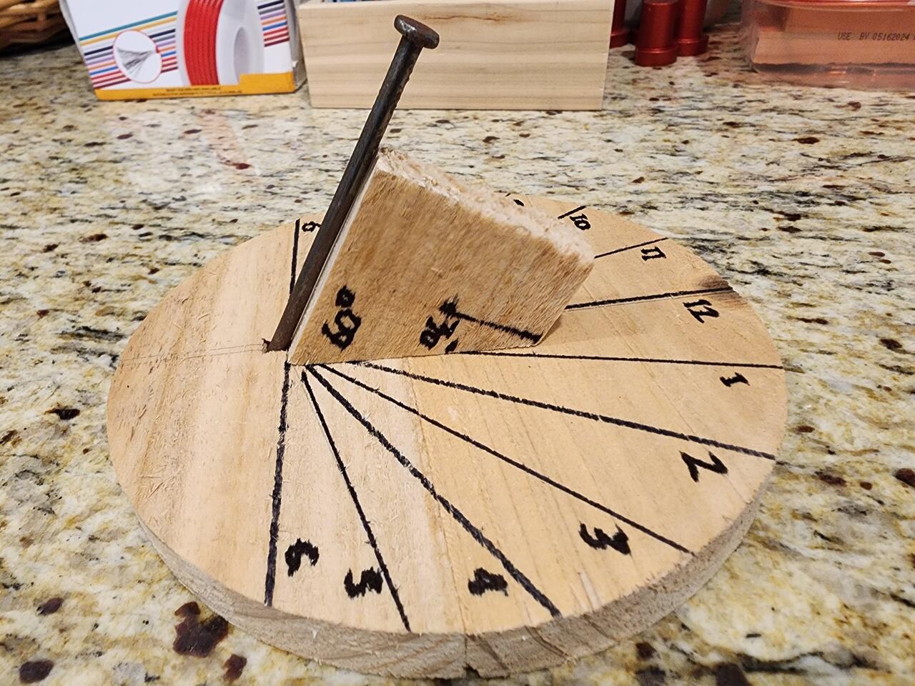

    Always curious about time keeping, clocks and... SUNDIALS
    Quick research on the internet says the gnomon has to be at an angle same as your latitude... mine is 29.76°
    cut a guide alignment block at a hair less than 30°. Using a 4" nail as the gnomon.
    My other choice was drilling a hole at almost 30° using the drill press and a angle drilling jig of some sort with a 1/8" or 3/16" dowel as a gnomon.
    Click image for larger version  Name:	20240512_185327.jpg Views:	10 Size:	215.3 KB ID:	858875
    30 minute project later...
    Click image for larger version  Name:	20240512_183644.jpg Views:	0 Size:	164.4 KB ID:	858873 Click image for larger version  Name:	20240512_183630.jpg Views:	0 Size:	180.2 KB ID:	858874
    So the next instruction is to point the gnomon at the north (solar) pole.
    darn. Overcast.
    Needs new batteries, I guess.
    The long term problem is the 5, large 33-year old live oak trees. Not too many continuously sunny spots left on my property.

    QUESTION: How did you arrive at the placement of the horizontal line that is marked with "6" on both ends, and is where the gnomon is also located?
      • 22081
      Originally posted by leehljp
      "darn. Overcast.
      They just don't make them like they used to!
      The point of the Gnomon is located on that line, I arbitrarily chose that point, close enough to one side of the base to still have 6 oclock radials of a decent length. Any farther down and the 6 o'clock radials would be very short. Higher and you'd just use half the base.
      So yeah, the point of the gnomon is a little off. I drove the nail after I drew the markings...
      You could in fact lay this out on a square or rectangular base, some use a semi-circle; a circle is not a requirement. The time lines radiate outwards from the junction point of the 12-oclock radial and the 6 o'clock radials. One hour every 15°.
      Higher latitudes with long summertime daylight hours you can put radials for 5 AM and 7 PM below the horizontal line and see shadows.
      This clock doesn't know about DST, though.
      If you look at this one, the line connecting 6 and 6 (VI to VI) is through the base of the gnomon. and the Line is offset from the center of the circle an arbitrary amount.

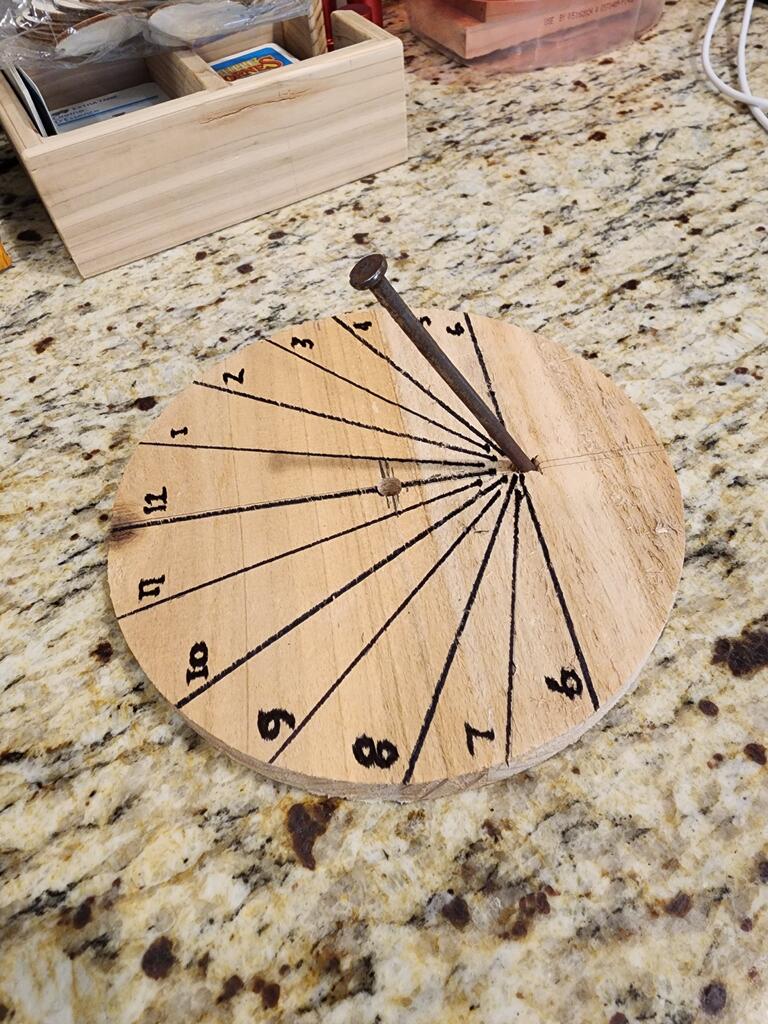

        Click image for larger version  Name:	image.png Views:	0 Size:	322.5 KB ID:	858881
        A few other designs. Pondering what I could do to make an interesting modern looking design.
        Building a quickie always gives you insights.

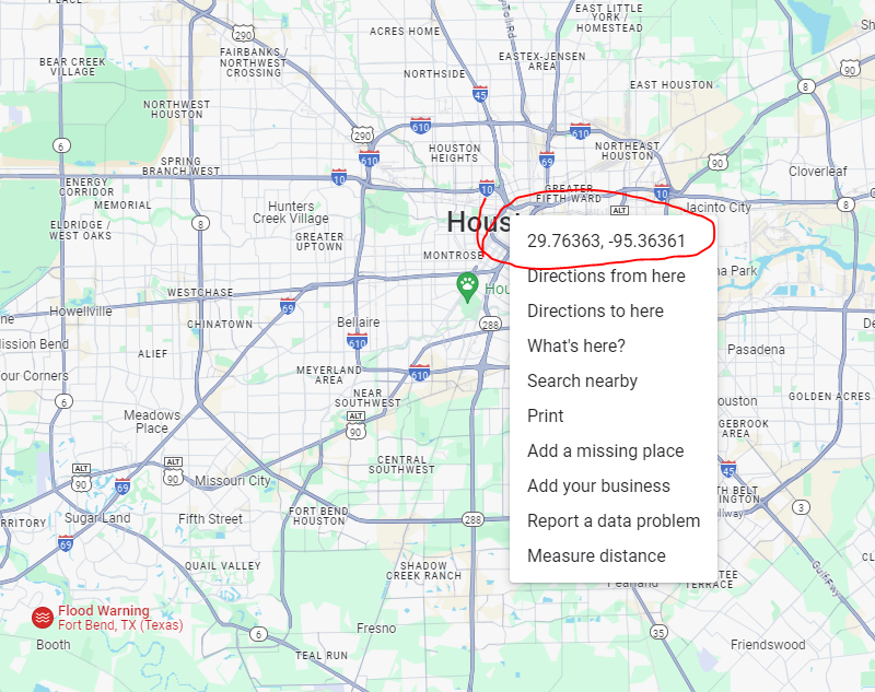

        A useful link:
        https://www.instructables.com/Horizontal-Sundial/
        And you can get your Lat/Lon by right clicking on your location on Google Maps.

          So I learned one thing already... using a round item like a nail for the gnomon is not a good idea.
          The shadow it casts is wide so making the time determination imprecise.
          The use of a triangle as a gnomon casts a sharp line of light/dark which is much more precise. Its only a wide shadow at noon.
