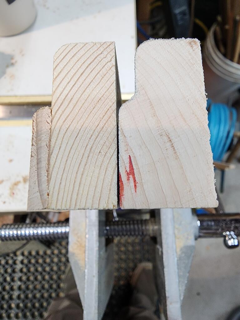

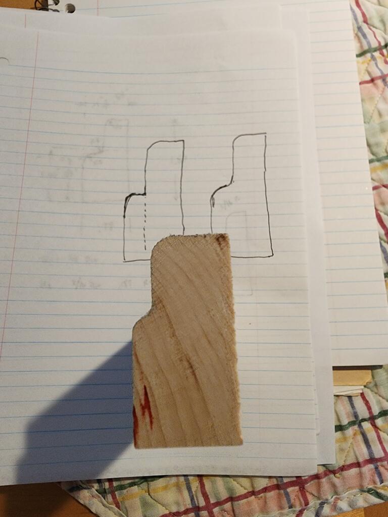

    .75" x 1.57" overall the two upper left roundover radii are 3/32" and 3/16".
    I'm figuring the only way to make something close is the left sketch two pieces glued together but you get a square inside curve instead of an S-curve like the sample shown.
    Is there any reasonable way to make the inside part of the S-curve to look like the sample and the sketch on the right? Other than a custom molding bit. Can't even use a standard roundover bit which makes a 90° part of the curve and I only want about 45° of arc. And then the inside curve needs 135° of arc.
    I'm thinking making the glue-up two parter and then using a small bead of caulking smoothed with a fingertip to take away the sharp inside corner. Still not perfect.

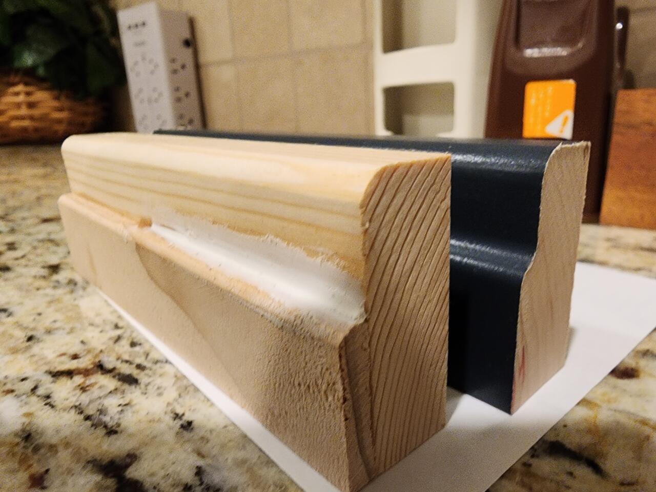

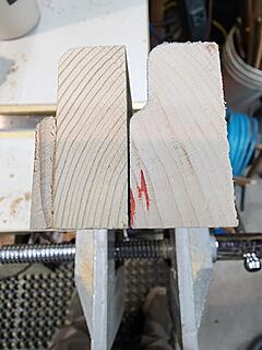

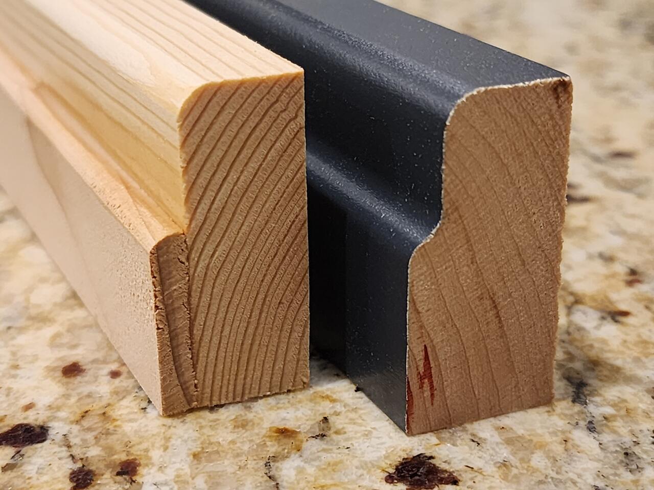

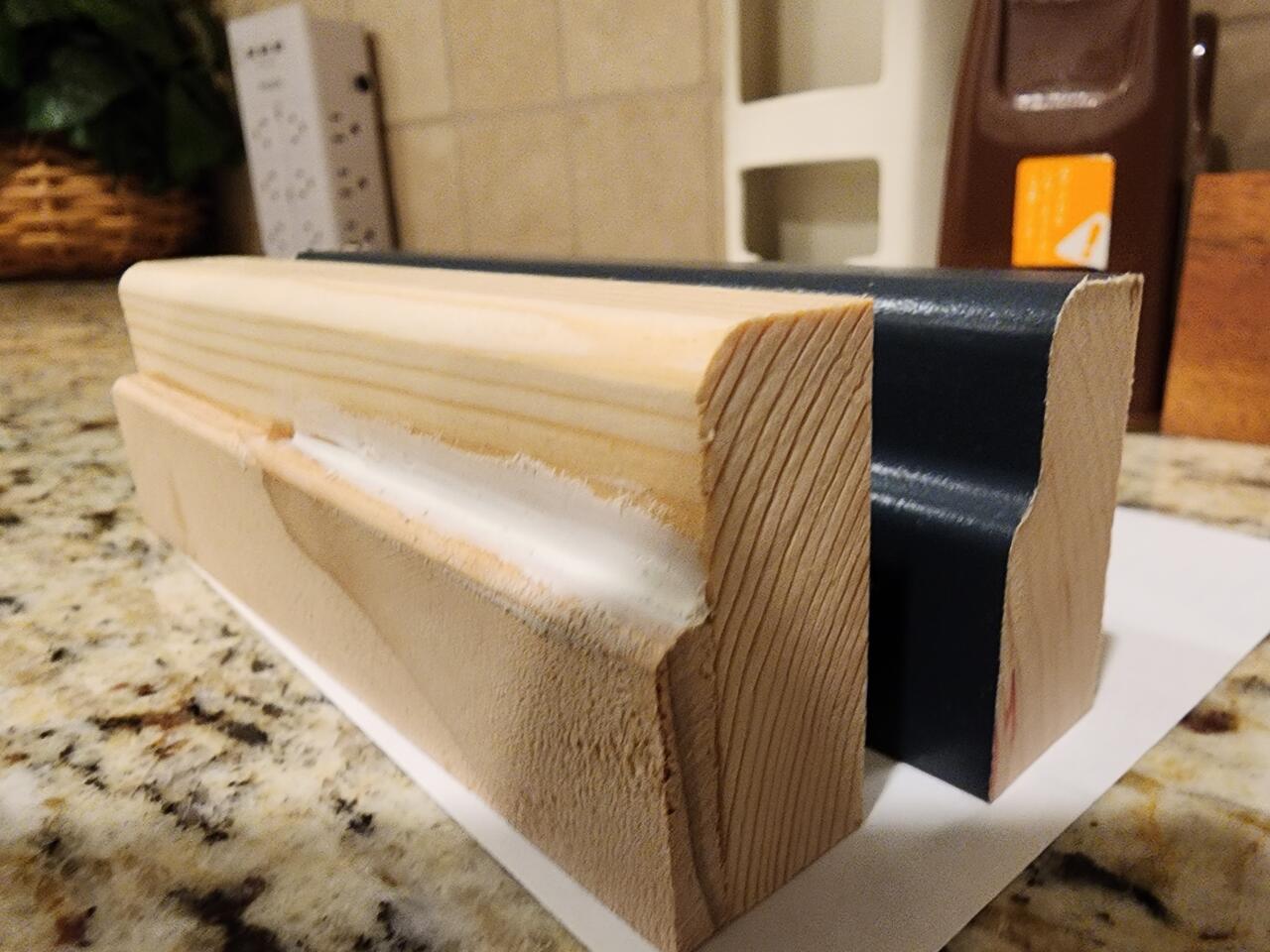

              So this is what I came up with. Two piece molding instead of one. The small roundover is more like 1/8" than my original guess of 3/32".
              The blue painted one is the original; the unfinished one is the clone.
              If they don't like the square inside curve, I'll put a bead of caulking in it smoothed with a fingertip.
              It won't be adjoining existing molding directly, it will be across the room.

                Click image for larger version  Name:	20240405_214708.jpg Views:	0 Size:	130.6 KB ID:	858471
                Here's a test bead. Is DAP latex trim caulk the right stuff? Lasts a long time?
                Needs to be a little thicker, I think, I just used a finger tip.

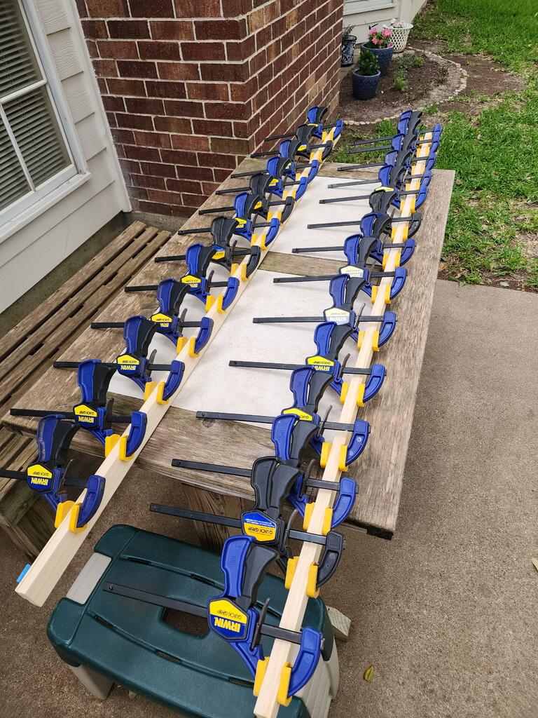

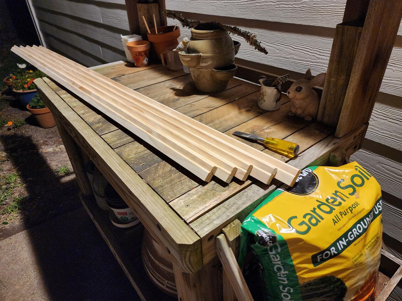

                Click image for larger version  Name:	20240415_211313.jpg Views:	0 Size:	228.0 KB ID:	858555 Click image for larger version  Name:	20240415_173100.jpg Views:	0 Size:	292.4 KB ID:	858557 Click image for larger version  Name:	20240415_172739.jpg Views:	0 Size:	200.1 KB ID:	858558
                Click image for larger version  Name:	20240415_211213.jpg Views:	0 Size:	211.8 KB ID:	858553 Click image for larger version  Name:	20240415_211150.jpg Views:	0 Size:	220.0 KB ID:	858554
                Click image for larger version  Name:	20240415_211217.jpg Views:	0 Size:	222.8 KB ID:	858556

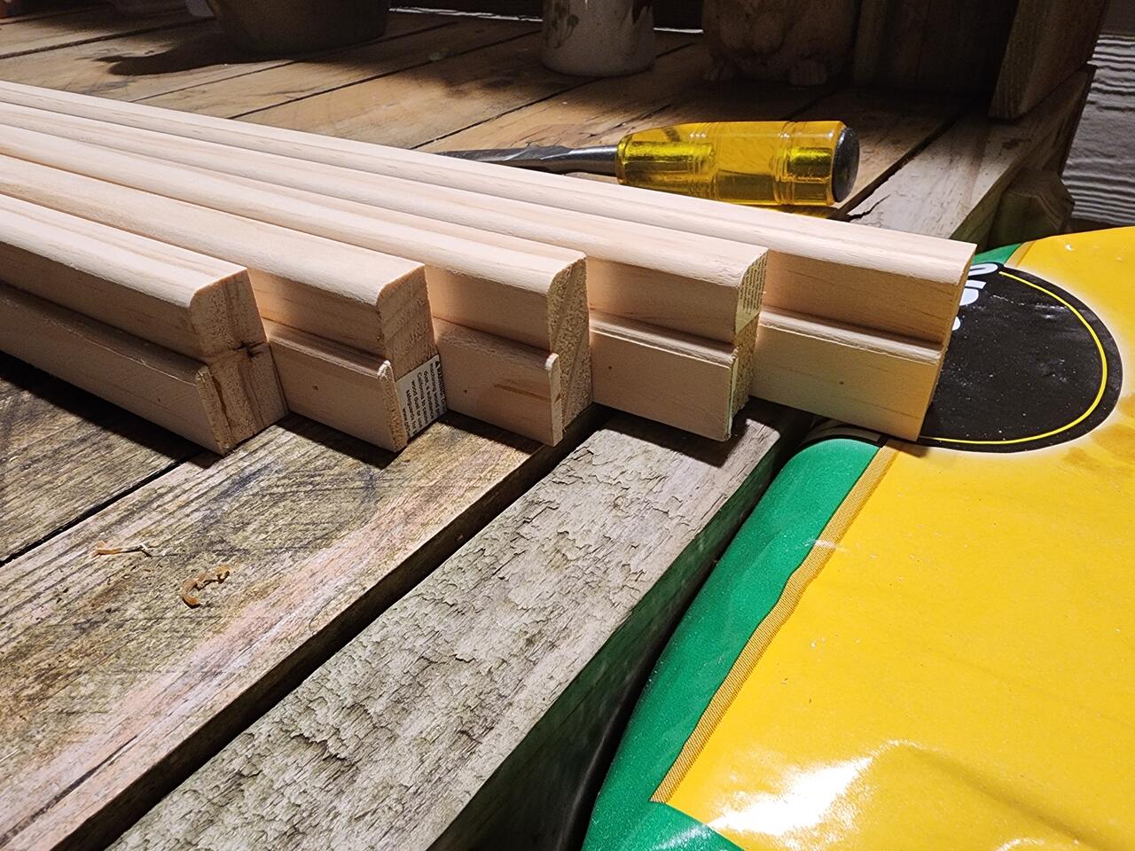

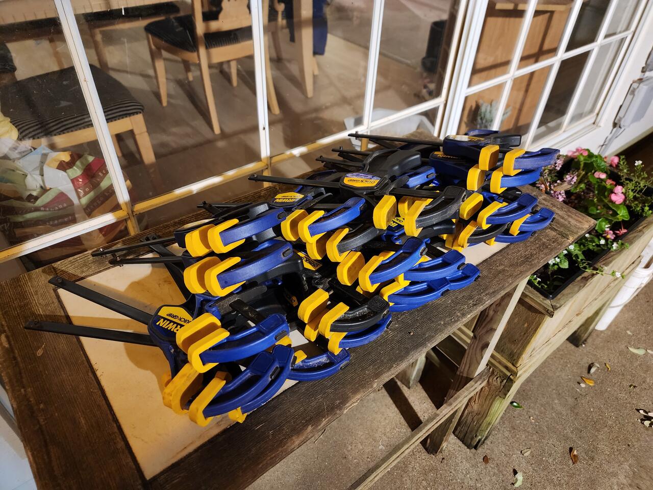

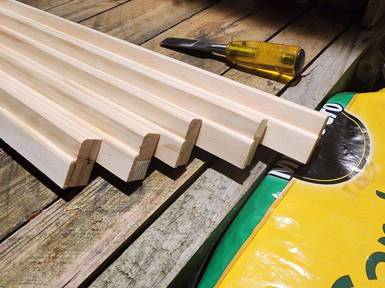

                Glued the strips to the larger piece and also used a pin nail every foot or so and then clamped lots of clamps because the thin piece was only .150" thick and needed it to be flush tot the larger piece.
                30 feet all done. Except for the caulking of the inner joint after priming.
                Impressed myself. 24 year old BT3000 cut a lot of deep rips over 1-1/2 inches thick without any issue. Each 6-foot board required about 4-5 deep long rips.
