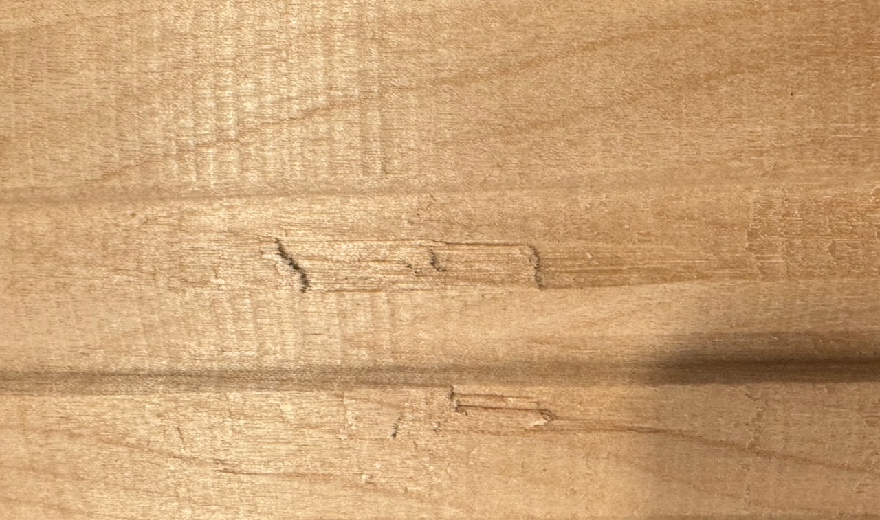

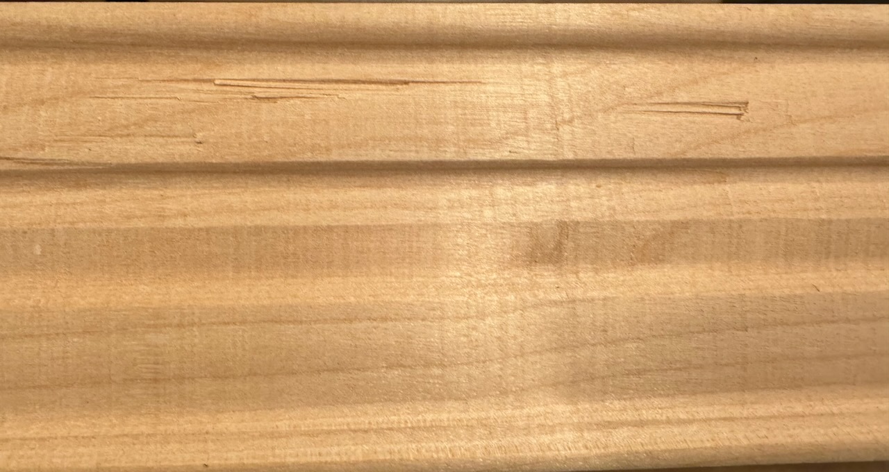

    I need to mill about 14 feet of crown moulding for my office and I'm having a problem with the birch splintering as I run it through the router table. I've ruined 6 pieces of birch already. I'm taking painfully shallow cuts as in < 1mm per pass, but every time the result is the same. Always in one of the later passes you can hear and feel when the bit grabs and tears a chunk out of the stock. I can't identify what is causing it and can't afford to keep shredding more birch.
    I'm thinking of trying to do this as a climb cut but my brain has come up with stupid dangerous ideas before so I don't always trust it. Any rational ideas on how to prevent the tearout would be welcome. At this point I may entertain crazy ideas as well.
    Examples of the tearout from a couple of the pieces.

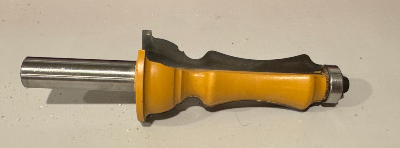

    This is the bit I'm using and I'm running the stock through the table on one edge and then flipping it 180 degrees and running it through the other edge. The bit was brand new before I started the process.

    Wet the board before cutting. Get a well dampened wash cloth, not dripping but close. Run it down the board so that it is good and wet on the cutting side. Let it set for 30 seconds to soak in. See if that helps.
    If I could make another suggestion: It might work better if the board was sanded a little smoother. I can see the waves from the planer and that "may" be causing some of the "grabbing" and splintering.

          I would try climb cuts in very small passes with lots of feather board and push stick controls. That said it could be a function of reading the grain. Can you choose boards with more of a quarter sawn grain and not flat sawn? I f you are shaving with the grain without climb cutting rather than feeding into the grain it might help.
          Are you using a zero clearance on the infeed side of your router fence so the board is fully supported before the cut?
          Maybe take a diamond hone to the cutter to sharpen it just a bit.
          Maybe the birch is the problem? can you match close enough another species, like say ash or hickory that might machine cleaner?

                I finally got back to this and the problem was partly not perfectly straight birch and mostly technique. As I was feeding the the stock through, it wasn't always staying tight to the fence and when I repositioned my hands, I would push harder and take ever so slightly larger a cut and that is when it would splinter. Using some scrap poplar instead of birch, I could cut it two passes with no tearout and much deeper cuts. Lots of featherboards.
                When I went to Menards to get a couple of pieces of poplar, premade crown was cheaper than the individual boards. I bailed on cutting my own crown and bought it.
