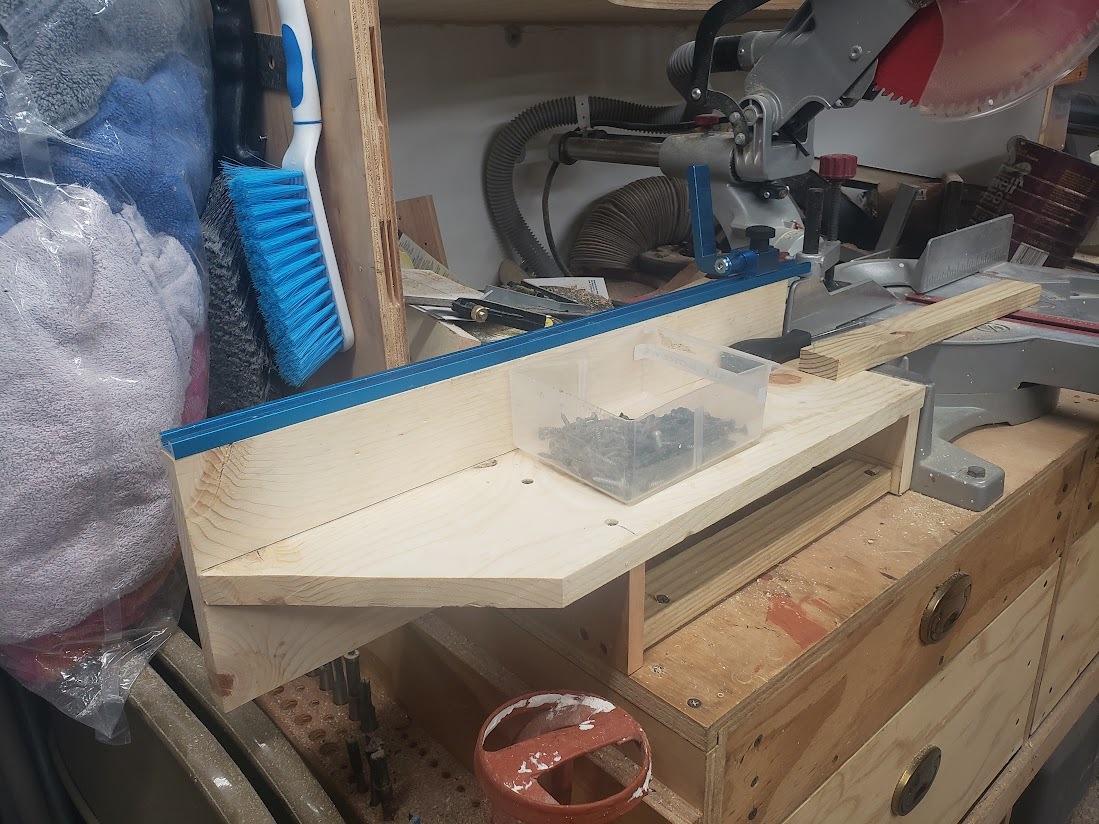

    Working on Version 2. Got the measurements which are honestly SOTP (Seat Of The Pants) measurement, basically far enough that I get the most out of it without hitting the freezer door...
    So far so good. The basic T is done, Corner braces to be cut from existing scrap, and will create cross cleats across the bottom to use for attaching to the bench. Then I work the one on the other side...
    It is nasty hot today and I have yet to go out this season and turn on the AC in the shop. VERY close to ready to do that...
      • 9226
      Okay so the left side is almost done. Cast off shelving material to the rescue. Straight, flat, big enough, and here...
      I extended the T track so that the slip stop worked all the way to the ends of the wooden extension table...
      Flip stop is a 3 inch PowerTech from Amazon, got them in a 2 pack and the T track is from a VERY old Rockler T track kit I got when I first joined BT3Central... I am thinking I should trim the lower part below the actual deck piece to allow easier access to the router bits.
