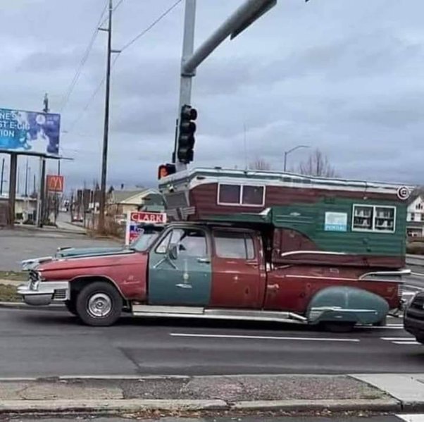

          I hope you are not modeling your camper after this beauty?

            It's hard to explain.
            My requirements are funny. I can't really afford a new truck as a nice 3/4 or 1 ton cost nearly what I paid for my house. So I am either stuck with my old 1/2 ton F150, or I buy an older Super Duty and psend a fortune fixing it up. I know the problems my F150 has... And my wife loves it. So we have to work within the capacity of a half ton truck. Good thing we have the payload package...
            But picture a commercial truck topper. Now make it tall enough to stand up in, extend the back so that it has a full door down to the floor, extend it rearward so it covers the tailgate folded down and uses that as a floor. Then extend the sides out so that a folding bed frame will support a pair of tridold twin mattresses which will effectively make up a shortened king size bed. The part where the bed folds into a couch will remain in place, and will have 2 compartments. One holds 4 separate Reliance 7 gallon Aqua Tainers and has a pickup that can be moved between, plumbed to a 12v pump, and a quick disconnect on the outisde wall of the camper / access panel.
            A fold down counter on the interior will provide "kitchen" should foul weather sock us inside, but for the most part, The side of the truck with the gas fill, which my brain is fuzzy right now but I beleive drivers side, will more or less be unused, passenger side will house the outlet for both gas and water for the stove, and hot water heater.
            My initial design may change due to losing my brother in law.
            The initial design was to have the hot water heater removeable so I could move it to a bunk house shower at his hunting property. With him gone, that obviously is no longer a concern. But should campsite not be condusive to having the privy next to the camper it would be nice to be able to hang it where I need it...
            Think Privy sort of off at the corner of the truck.
            An awning will extend a bit under 10' and cover the kitchen area. I am thinking a table that can hook to the tire since I run 35s it should be plenty high enough. Deployable sides via velcro are planned to enclose the awning should weather require it
            The camper body itsef is planned with a cabover, but not a cabover sleeper, more of a cabover storage.
            It should be noted, I was working on ordering a camper from Eureka Campers a few years ago, when the salesman stopped responding. Good thing I hadn't put my deposit down, they went out of business as the owner had died and had no heirs... A loaded out Eureka is only 900lbs with AC and a fridge... I would RADICALLY prefer the Eureka camper, but since they are few and far between, and camper MFGs that make "half ton compatible" campers these days are aiming for pop ups, not what I want...
