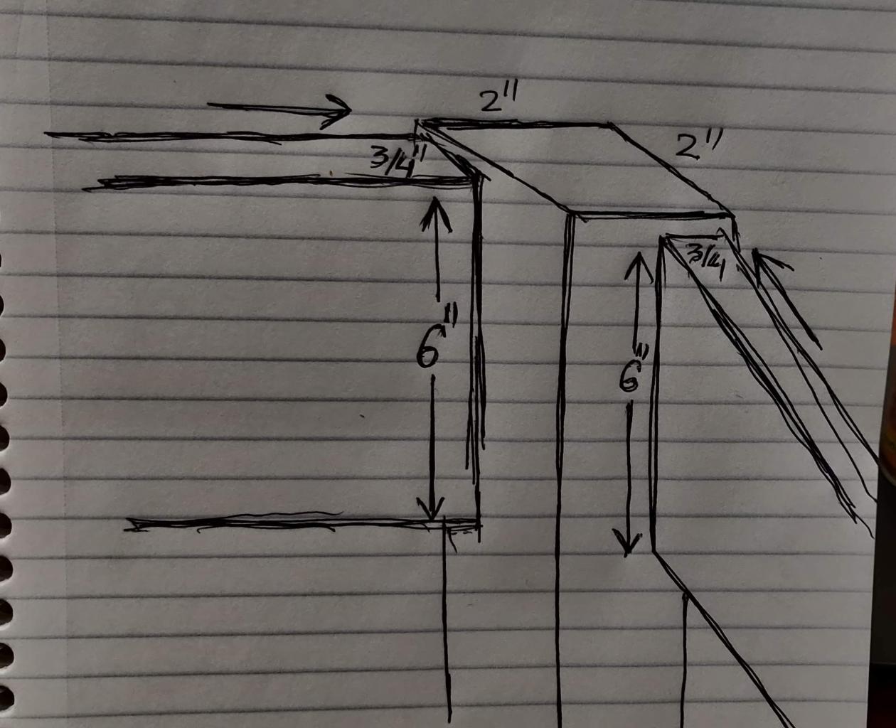

    I want to attach two 6" wide boards to a 2" square post, essentially butt-joints for the 'aprons'. (see pic below)
    This will be for an elevated garden bed in the yard, so nothing fancy, but I can't have it fall apart too soon. I don't want to go cutting dadoes for this.
    I thought pocket screws, but will they stand the weight of 12 cu.ft of soil?
    Maybe I could add a tiny supporting bracket below each apron end, and that should be enough reinforcement? Or should I add a crossbar on the inside that I can attach to the post with screws?

    1. Multiple biscuits and waterproof glue.
    2. Counter bored stainless steel screws through the outside of the posts into the ends of the sides and plug the counterbores.
    3. Small square blocks glued and screwed to the side boards and the legs.
    Jim Frye
    The Nut in the Cellar.
      • 2812
      Biscuits are okay and certainly the fastest IF you have a biscuit joiner, but I think dowels would be stronger. For years I've used dowels as they were often used in commercial tables for the 'skirts' as you have sketched.
      A few years ago I bought a biscuit joiner and I really like it for edge-joining boards to make larger table and bench tops. I don't know about end grain though, just seems a weaker glue surface. For that application I would consider mortise and tenon, but it is by no means quick!
      • mpc
        • 1018
        • Cypress, CA, USA.
        • BT3000 orig 13amp model
        If the planks can be made from glue-ups, consider face-gluing two panels to make one thick piece. Before gluing them run a pair of grooves in each one, on the faces that will get glued together. That way you'll end up with two channels end-to-end and can use two long threaded rods to tie into the posts at each end. Drill counter bore holes in each post for washers+nuts, then plug the holes. Somewhat similar in concept to how some folks make blanks to become floor lamps. The threaded rods would be long, and probably a little pricey, but the advantage is they'd apply squeezing pressure to the whole assembly so even if the planks crack or otherwise get damaged over time it would not be a problem as they aren't the main structural pieces. Use a router cove bit, instead of a dado stack, and you'll have circular cross section channels that you could epoxy the threaded rod into for a really beefy structure.
        A variation is to use hanger bolts - those that are wood threads on one end and machine screw threads on the other end. Again, you'd have to bore through the posts for washers and nuts if you put the machine screw end into the posts. You could put the wood threaded end into the post, then drill a channel into the end of the plank for the machine screw end; use a Forstner bit to drill from the inside face of the plank to the end of that channel for a washer+nut similar to some counter top or bed frame attachment methods. This would allow future disassembly of the project to repair/replace pieces.
        Big dowels or Dominos/floating tenons possibly?
          first concern:
          A cubic foot of soil weighs between 74 and 110 pounds, depending on the type of soil and how moist it is. Dry, loose dirt weighs about 76 pounds per cubic foot, while moist, loose dirt weighs 78 pounds per cubic foot. How Much Does a Cubic Foot of Soil Weigh? | Reference.com
          www.reference.com › Science
          Yeah, you are looking at possibly more than 1200 pounds, more than 300 pounds on each corner joint for water saturated dirt.
          You can't cut corners on this one.
          Mortise and tenon. Or some beefy, multiple dowels.
          Your best bet is to add a 45° crossbrace that is securely fastened into each side apron and then a couple of big lag screws (or hangar bolts) into the leg. Or they offer some steel brackets for this.
          Remember this is NOT a table where the weight of the table top as well as the load on the table top will be resting on the legs.
          If you hang some stuff and the weight is hung from the aprons the joint will be carrying a LOT of weight and the 3/4" boards will be carrying several hundred pounds.
          Some serious beefy legs like a 4x4 might be better with 2x6 aprons so you can get some serious fasteners into it.
          If looks and craftsman ship are not primary but quick is, 4x4 legs and 2x6 aprons lag screwed two in each end to the side of the leg might be stronger ultimately and give you the simplicity of a butt joint.
          I'm really serious about the weights!
          Tiny brackets will not serve you well..

            Very good points, everybody! Loring, that weight aspect is spot-on!
            I have the Dowelmax, so I will use dowels for the joints, and then add cross braces at all four corners.
            Since this will be a 6' long bed, I will also add small posts/legs in the middle at the 3' point.
            Probably a wee bit more time and effort needed than planned, but best for peace of mind, and where else am I going, these days?!

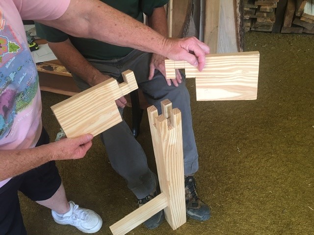

              I like this construction for table/ apron connections over mortise an tendons. My sawmil owner had this table leg and apron demonstration piece showing how he constructed tables. I like it for a sturdy table. I would probably finalize it by putting in a couple of pocket hole screws to tighten it up.
              like Lchien said, it’s a lot of weight. Considering this fact you might consider making a sturdy bench and set the planter box on top of it. 4x4 legs might be in order to keep it sturdy and reduce the chance it might tip over.
              Im not sure I wouldn’t just screw the aprons to the side of the legs rather than trying to make it like a table. Either way you have to deal with how to cut in the box bottom to prevent leakage.

                That's a very interesting contruction, Cap! And I don't think it should be very difficult to cut either.
                I'll try and incorporate that in my next project, thanks.
