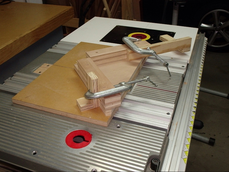

ID:	827288I have a miter sled that saddles my rip fence that I use to cut the top and bottom bevel on my tiny table tops. I've tried to make the bevels for boxes on it before and never got them perfect. I use the rip fence sled vrs the miter slot sled because of various adjustments I make to each table. The attached photo is an earlier version that was later modified considerable to saddle the fence better. There is absolutely no movement in my fence or this sled.

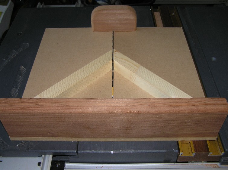

                Are we talking about "bomber" sleds? I found this picture of one I made - and another posted by JR - some years ago. Mine:

                  LCHIEN commented
                  Yes, those are classic BT3 miter sleds.

                    My rip fence jig handles a 24" high board.mThe photo in my previous post shows a 10" X 20" board in the jig and the next cut it is going to do is the 20" board standing up. I would recommend a regular miter slot type sled over my jig because of the other variables that sneak in on you when using the rip fence jig.
