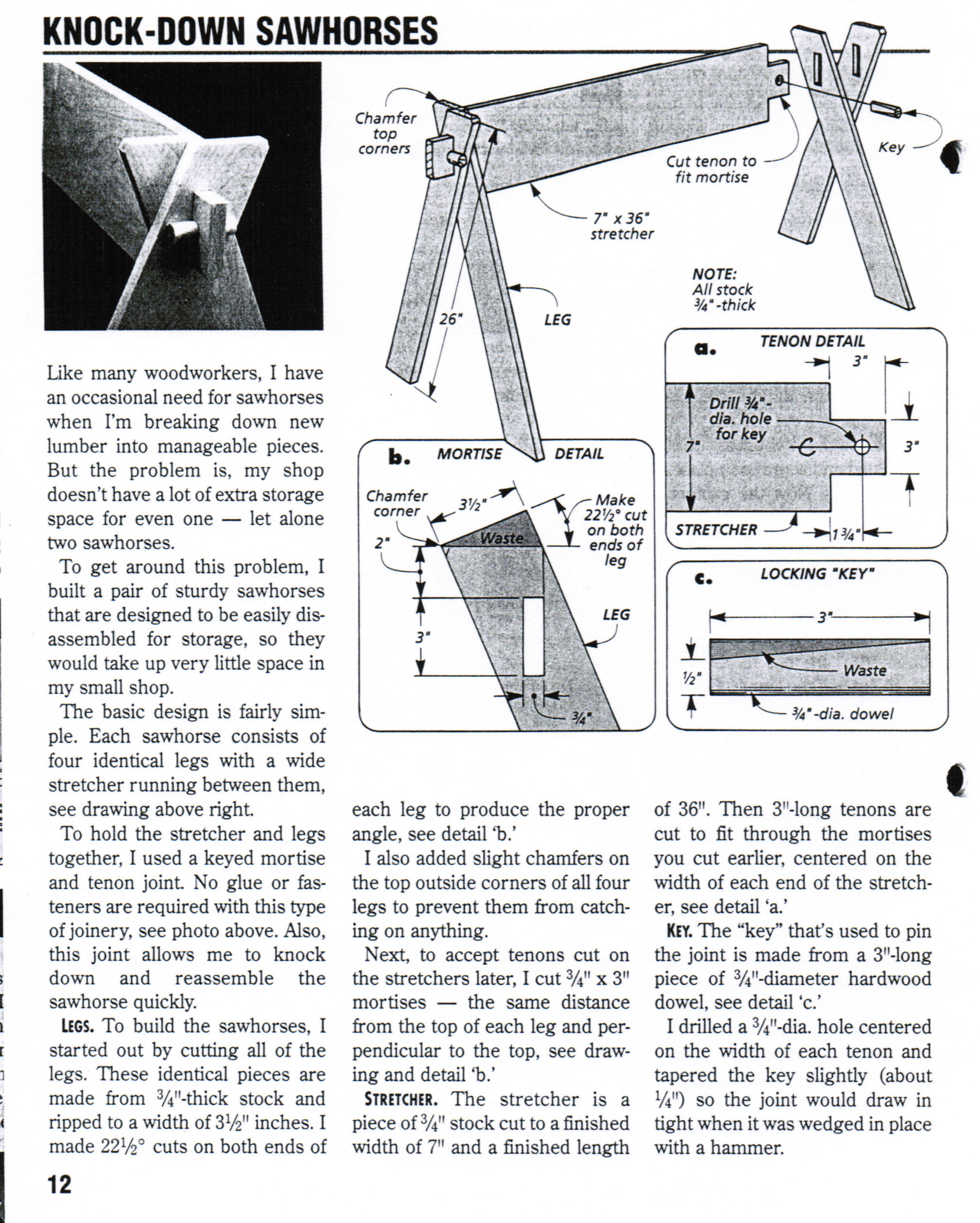

            ShopNotes deign of a sawhorse, no hardware, all 1-by lumber.
            Here's a knock down sawhorse - you can make each sawhorse from a 1x8x8.
            So two sawhorses cost about $20. No hardware required - no screws, nails, hinges, staples, brads.
            I have two of these and they are nice and compact in storage. The key is the dowel wedge, need a two 3/4" x 3" dowel for each sawhorse.
            Because the legs are 3/4" thick it has a little wobble in the sideways direction where the legs are thin, but it's not bad.
            Construction hints:
            Buy a 1x8x8, Crosscut a 36" piece for the stretcher, then rip to 7" wide.
            Take the remainder and rip to two, 3.5" pieces. Use these to make the legs.
            You will find a 1x8x8 cheaper, straighter and flatter than most 1x4s' at the BORG or Lowes.
            The angled slot will be hardest thing to cut. Make a 22-1/2° jig for your mortiser (so that you can slide the wood to line up the next cut), or, if you don't have one, you will have to drill a series of 3/4" holes - make a 22.5° angle jig to guide the wood against the DP fence to align the holes perfectly, then chisel them out the rest of the way.
            This was a real fun project from early in my hobby and its a cool idea. you get to practice all the basic skills of ripping, crosscutting, mitering, mortising and notch cutting.

                      So for a learning experience And inexpensive ($10 each) I would recommend the one I posted the plans for above... not so shaky as Cman suggests because thelegs are doubles up for part of the way. And OK for support but maybe not sawing where you need something stiffer.
                        The word I used was unstable, and 3/4" legs would be IMO. It may be a matter of safety to have stands that are both supportive and stable.
