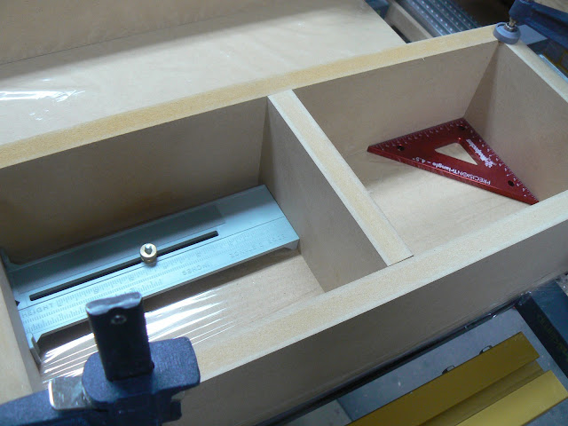

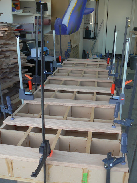

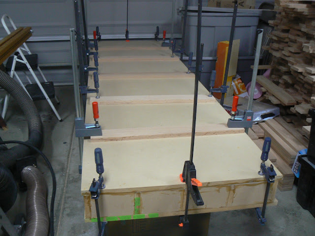

          Here are some pics of the construction. The biggest hurdle was to rip ten 3-7/8 wide boards from the two 20x97 MDF sheets. I decided to use five 97 inch long ribs and then 48 6 inch long connecters. As the ribs and the top and bottom were all 97 inches and I didn't feel like trimming anything I used connecters on the end as well.

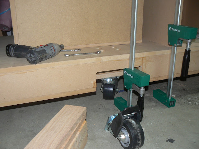

          The spacing is 8 inches lengthwise and 6 inches widthwise. This will work out well when Amazon delivers my caster. I ordered 4 inch plate casters with double lock. My plan is to mount them in the third "well" from the ends to create a 55 inch span in the middle.
          Everything went together pretty well. The Woodpeckers triangle and General Ultra Gauge which just happened to be exactly 8 inches long (Incra clone) worked beautifully.

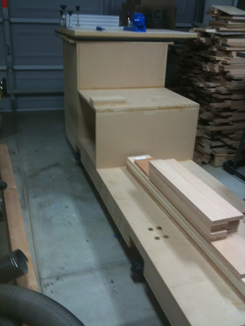

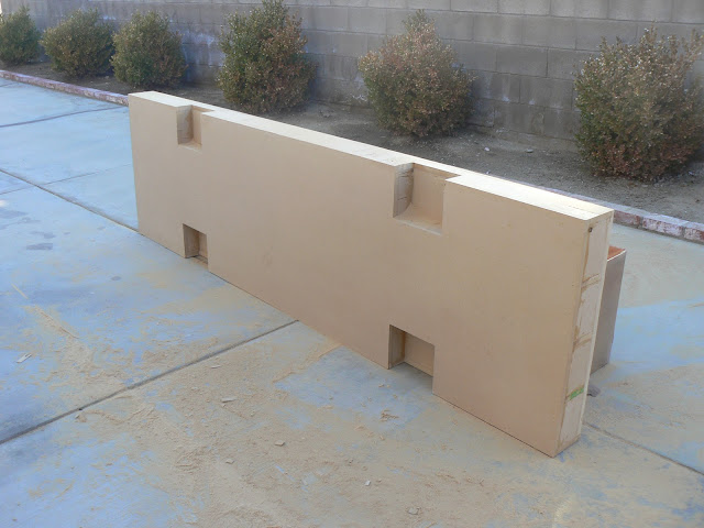

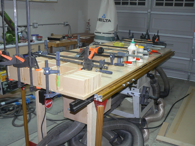

            More pics from today
            Finished the edge trimming and the wheel wells after completing the box last night. The mobile base is going to be a lowrider! And it is HEAVY.

                  On your glue up, you would have transfered for clamping pressure to the middle ribs if you would have turned your cauls on edge. A caul with a little bit of a curve will work even better than a straight one.

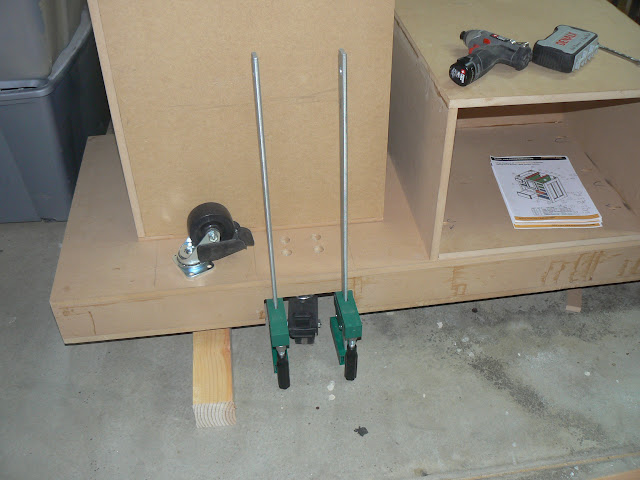

                  How big are your leave-outs for your casters? I did a recessed caster base for a buddy twice, the second time was to make room for the caster to pivot the full 360 instead of just a portion due to the small leave out I did.
                  • Poobah
                    • Sep 2010
                    • 77
                    • SoCal
                    The cutouts are 8x6 inches plus the another 3/4 added to the 6 for the sidewall. I thought about how the casters would fit and ordered a 4 inch total lock caster from ER Wagner. At worst I figure it will need an 8 inch diameter circle, but I suspect it's less, maybe 6 inches.
                    Wish I had known about putting cauls on edge. I have plenty that are slightly skewed too.

                          Update with pics
                          Sorry, it's been a while, but I've made some progress ...
                          First is one of the four phenolic tops I got for $35 a piece.

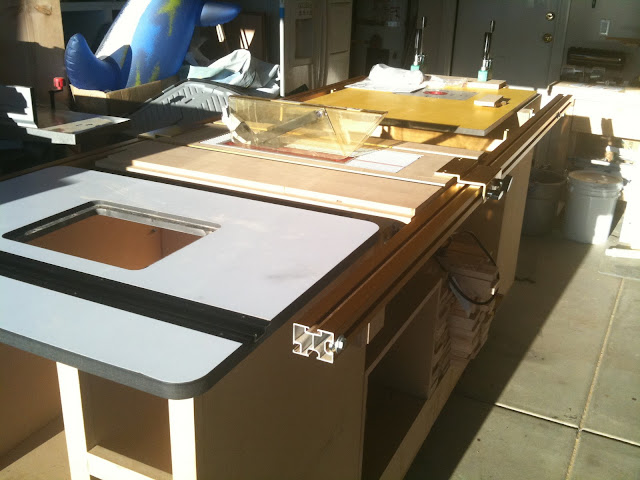

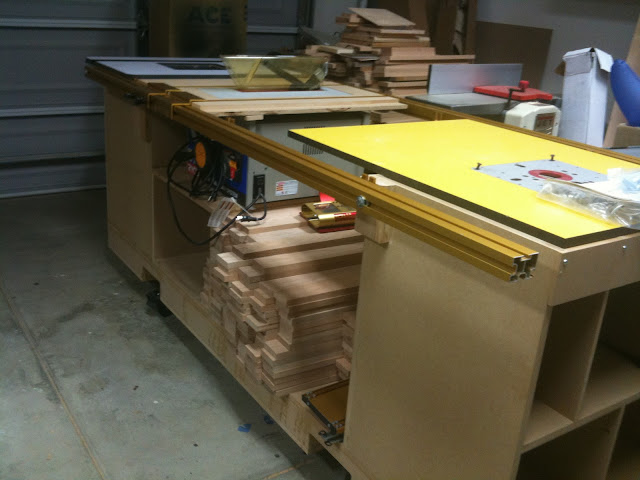

                          Next, I've built and mounted the left side router cabinet and the saw stand (little did I know at this time I am off by 3/32 in height ... more on that later)
                          Next is close to the current state. I haven't fully assembled the Incra positioner, but the rails are just about right on as well as the saw table extension with miter tracks. I will probably rebuild that part as it currently is just MDF and the miter tracks are 0.02" off over the 32 inches depth. I swear when I assembled it it was no more than 0.005". The front on the right side router base is just something temporary to give it some rigidity. I figure some day I'll build a face frame and finish it off correctly.
                          I've at least temporarily put my router lift on the far right due to the aforementioned 3/32 inch issue. I also got a Triton router from Peachtree on sale recently and was thinking about putting that on the left side.

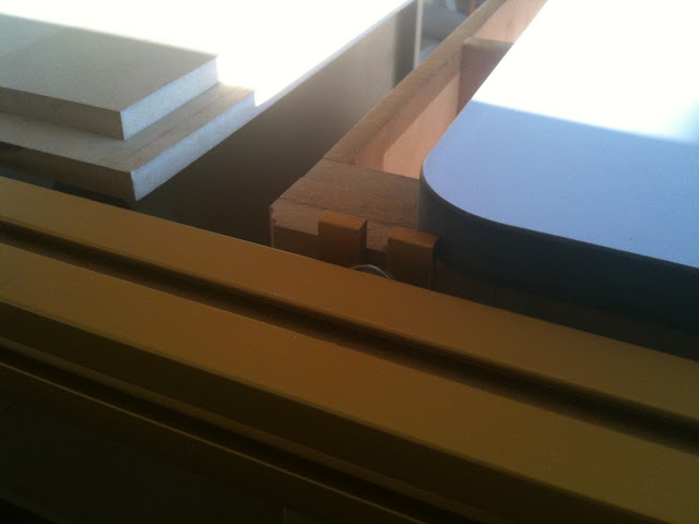

                          In the next picture you can see my little issues. First one is that the Incra brackets are a little above the top level of the base cabinet. I knew about this and had decided a while ago I would either add another MDF layer as a spacer or something or just rout out a slot out of the router table top at the back right and left corners. Incra just suggested I take a chop saw to the bracket and solve my issue that way. Sounds good too I guess.
                          But the more serious issue is that even though I spent weeks measuring and drawing and calculating (and being a statistician you'd think I could do this somewhat without error) I built the base too high or the table saw riser too low. 3/32 is the key number because the router table top is 29/32 high. I probably subtracted 3/32 twice somewhere or something stupid like that.
                          The bottom line is this: the left side router top is too high relative to the saw table top. And since it is only another 8 inches or so to the saw blade I really need to fix it.
                          A. I could rout slots underneath the router top to fit exactly. With the router lift and the Incra positioner I can do this quite accurately.
                          B. I keep thinking about how I can "accurately" trim 3/32 off all the walls (two interior walls - think std looking router cabinet) and thus lower the top to the right level. The outside could be done with a rebate cut from the top and then a flush trim bit from the sides. But I can't think how I would do the interior walls.
                          C. Raise the table saw 3/32. But then I also have to add 3/32 to the left side router cabinet which is set exactly right for the 3/4 thick penolic top.
                          Anybody have any other ideas or suggestions?
                          One more view from a different angle

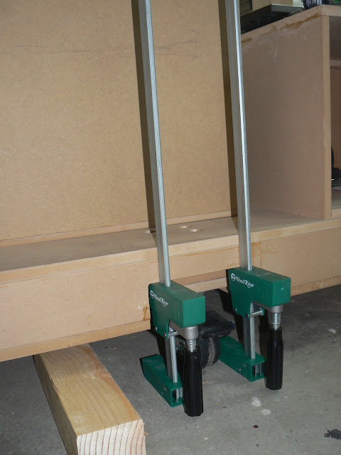

                            I ordered 4 really nice ER Wagner casters. Unfortunately they sent me 3 matching ones and the 4th was cheaper with a lower load rating. The company has great customer service and they quickly fixed the issue, but now I had to change out a wheel. So here it is for you NASCAR lovin' Talladega Nights fans:
                            Yes, that is a parallel clamp jacking up the mobile base! I don't know why, but that really cracks me up.
                            And this wouldn't be complete without the rest of the evidence

                              One more note. I think the base might be sagging ever so slightly at the ends. Of course I haven't really added much weight to the middle and those router bases are pretty heavy.
                              I still think it was the right choice to move the wheels inward. At 97 inches you would get a lot of sag in the middle otherwise.
