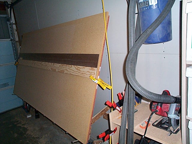

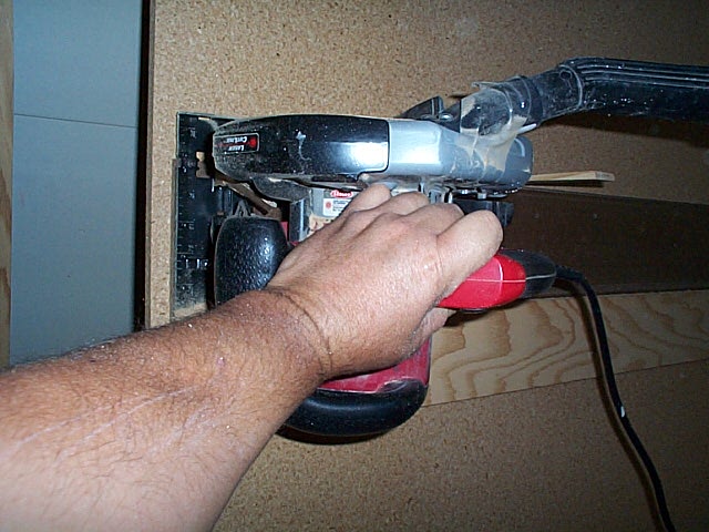

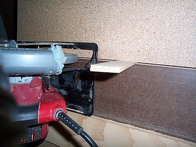

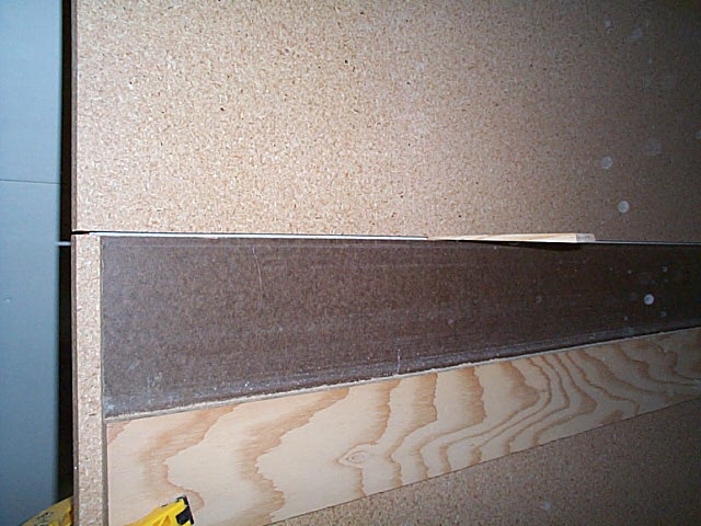

        I use a 60 tooth blade on the skill saw that iI use for my panel cutting area. Here are some pictures of the area and the way it is used I can do dead accurate cuts that i don't need to resaw on the table saw
        Art
