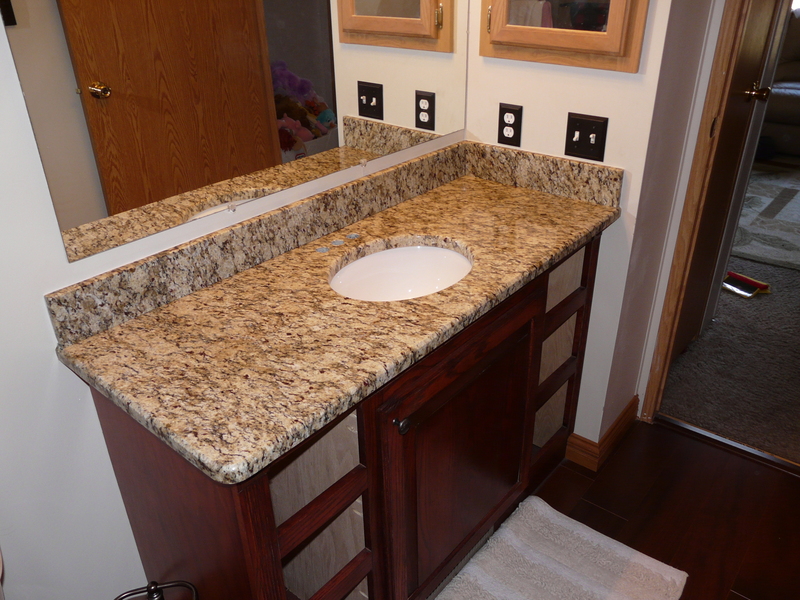

              I used oak veneer on my bath vanity. It stains great. I did however use a grain filler, because I wanted a smooth finish. I actually used Bartley's, but their website is down. Here is a similar product http://www.briwax.com/products/grain_filler.htm
              I'll see if I can get some pictures up of my progress.

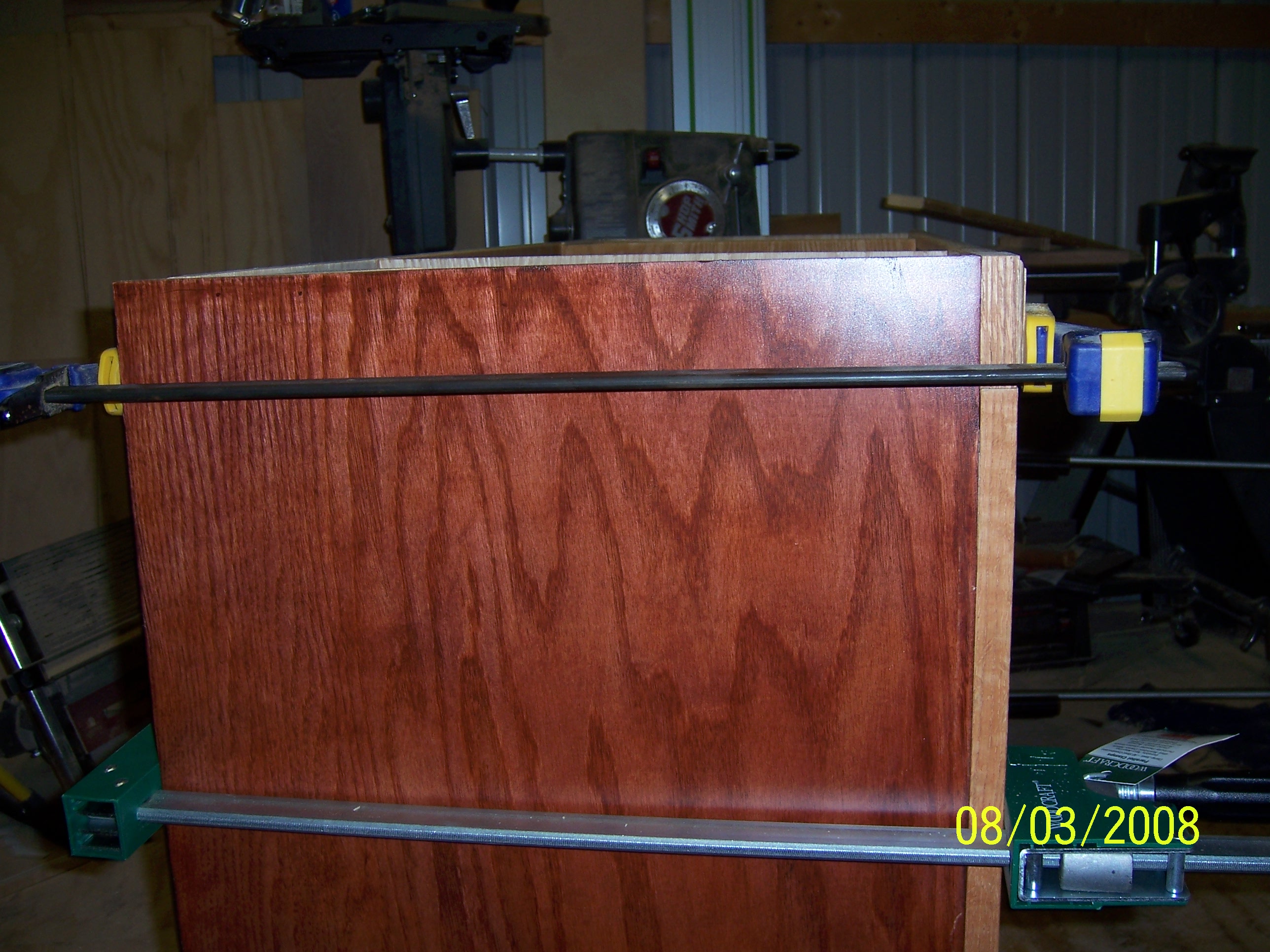

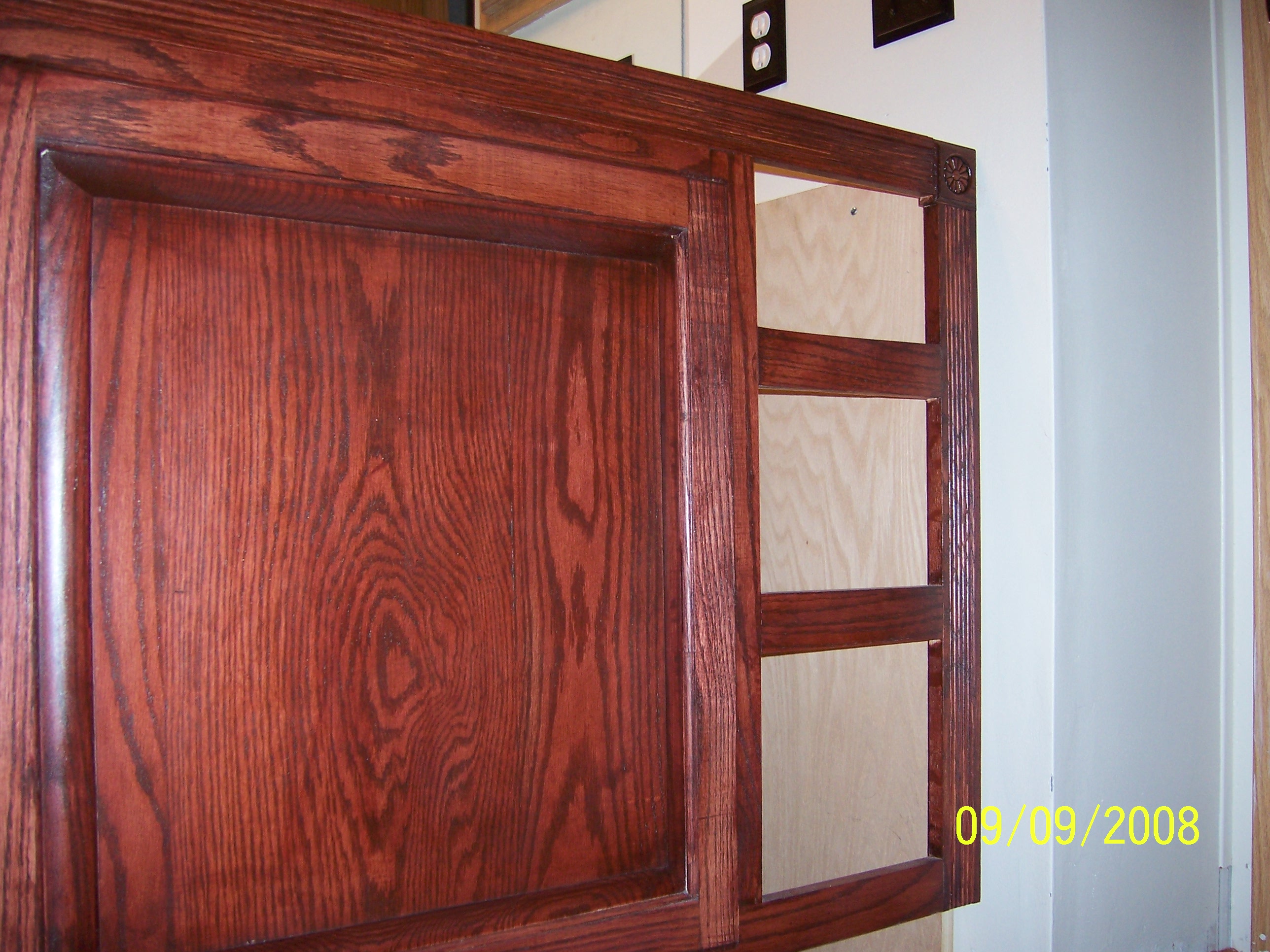

                more pictures. I always have a hard time resizing them.
                  Are you thinking about the " all in one" minwax? That's the stuff that is really a tinted poly. There's not really any penetration of the wood. Now, staining veneer may not be a problem as the veneer is really, really thin so anything you apply won't soak in very deep anyway. I would be concerned about the mdf "pulling" the finish through the oak but the poly in the finish should slow this down.
                  You may try thinning with mineral spirits and try on some scrap first. You will have to build up a few coats this way but it would give you more control.

                              Sorry for the slow response. I used a stain I got at Woodcraft, here is a link http://www.woodcraft.com/family.aspx?familyid=5555
                              It was the General brand. Here is what I ended up doing.
                              1. stained it in a cherry finish
                              2. applied the Batrley's grain filler. (I bought both kinds for dark and natural. I ended up mixing the two together to get the color I wanted.)
                              3. sand it off using a random orbit sander, going through the grits, I think I ended on 320. It left the filler in the grain, but actually took off the first layer of stain, except what was covered by the grain filler.
                              4. stained it with General's mahogany finish (which is darker than the cherry)
                              5. some areas I used General's java colored gel stain, such as the rosettes to give it a antique type finish.
                              6. I bought a poly that was in a can, and sprayed it on, used steel wool in between coats. I figured the spray on would give me the smoothest results.
                              Like I said, this was my first time doing this, and was the first cabinet I ever built. I know I had to make some mistakes, but I am happy with the end result.
