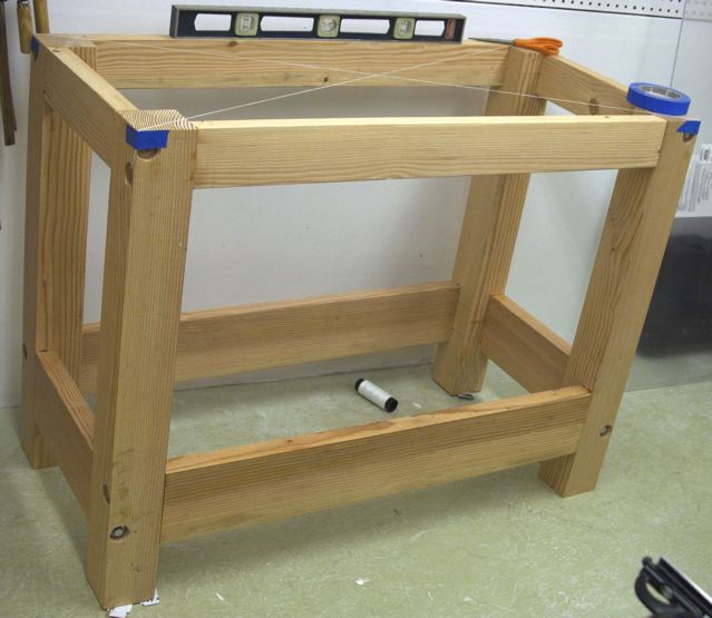

    Hi, everyone,
    I need some advice and insight for a little problem I encountered. The answer is probably obvious, but I can't really see it right now.
    I'm building my first bench, and it's been quite a learning experience so far. I'm using a very simple design with 4x4 legs and top and bottom spreaders all around using 2x6 and 2x4 Douglas fir. The top spreaders, made of 2x4's, are flush with the top ends of the legs.
    The problem is that after glue up, my bench legs are not perfectly flat on the floor. Two legs that are diagonal to each other are "longer" than the other two, so the thing wobbles. They did start out to be exactly the same length, which means that some of the legs are probably not plumb.
    I thought I should use the belt sander to trim the legs down a little bit, but when I turn it over, the table top is not level either. So it's kind of hard to find a good reference point.
    My husband suggests trial and error - that is, shave the legs off a little bit, turn it over to check, turn it over again to shave off, and so on. This is a VERY heavy base, and I don't really like the idea of having to wrestle with this thing multiple times. Besides, I have a feeling that it'll probably make things worse.
    What I think I should do is try to level out the top first by either shaving it or putting on a flat top (like plywood) and shimming it. Then turn it over, and use that as a reference. But that sounds pretty complicated. So the question is: Is there a simple way to do this?
    Thanks for any help,
    Anna

              Good advice so far, but the question you need to answer for yourself before proceeding is:
              Is the surface that the tabletop will sit on (stretchers/leg tops) in-plane now?
              If not, then shortening legs will only make matters worse.
              There's a good chance that the legs that seem too long at the bottom, are going to seem too short at the top.
              One way to check this is to pull a string from the top of one leg, across to the top of the diagonally opposite leg. Then, pull a second string across the tops of the two other diagonally opposed legs. Do the strings just touch in the middle?

                Hmm. Good idea. I only checked the top for level, and it's certainly not. I didn't think about it in terms of being "in plane."
                (5 minutes later....)
                I just checked it. They're off by 3/32", which is exactly what the "short" legs are off by!
                Edit: I forgot to ask: So how do I fix this?

                    First, you should determine if it needs fixing. The point being that with a little weight on top, the high legs may very well just settle into place. So, have hubby sit on one high leg (if we men can't be used for our intelligence, we can at least be used as dead weight ), and you push down on the other one. How much push does it take to straighten? How does that compare to how the table will be loaded?
                    BTW, what's the intended tabletop material?

                          I'm attaching a picture of the part I've put together so far. It's very solid. I doubt my husband (who weighs less than 160 lbs) and I (who weigh less than 110 lbs) would be able to twist this thing into shape just by sitting on it.
                          It's totally overengineered, I think. There are two rows of biscuits on each leg - making that 2 biscuits for the 2x4's and 4 biscuits each side for the 2x6's. Then I hit on the bright idea of using lag bolts to make it REALLY solid, for a total of 16 3/8" lag bolts on the legs so far. Of course the problem is that now, I can't twist or re-adjust the darned thing if my life depends on it.
                          The options are reduced to these two, as far as I can figure it: 1. Use levelers like Dave and Thom suggested, and 2. Do some shaving on both top and bottom. If I use levelers, then I'll have to use shims on top to make sure the bench top is level.
                          The bench top is going to be laminated MDF - 2 sheets of 3/4" MDF glued together - plus a 1/2" birch plywood on top to make it easy to replace. I wanted a butcher block top, but I figured I can always replace the top later.

                            Hi Anna,
                            Lookin' good so far. How does this sound (it's how I built mine):
                            "Find" a flat area to lay the top face down, upend the base and attach it to the top, drill and insert a 3/8" (dia. bolt) leveller in each leg. (With a friend), turn it the right way up. Level it.
                            I have a concrete floor that's anything but level. My bench and all my floor standing "cabinets" (DP router tables etc), all use levellers.
                            Not as well built as yours, but it is flat and LEVEL:

                              I think levelers are perfectly acceptable and maybe even desireable for this application. Don't think of it as cheating.
                              As mentioned, your floor is probably not perfectly level. Even if you get the legs trimmed/sanded to prevent the rocking, you might decide to move the workbench to a different spot someday (I've change the position of mine 3 times in the past year), and you'll have to start all over again because the floor will be different in the new place.
                              Also, if you decide to trim the "long" legs, you might find that after enough tweaking, your bench will end up being only 1' tall!
