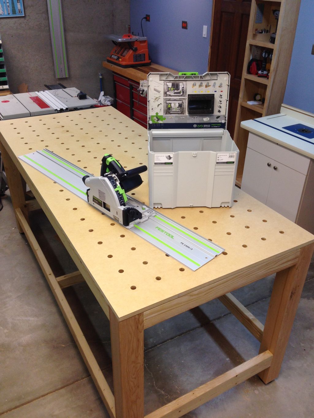

    I built my own workbench for use with my Festool track saw. But there is nothing that says this is not applicable to any track saw. I call it an "MFT-XL". Shown in the picture is the 55" rail. A 75" rail hangs on the far wall, so I can connect them and cut full plywood sheets.
    The MFT/3 was too small for my needs, and I did not need portability to enable it to be collapsed and hauled to job sites. It sits in my basement shop.
    I CNC-machined the top with 20mm holes like the MFT, and I own several sets of rail and bench dogs -- from Qwas, and also the Parf Dogs from Lee Valley.
    My goals were to build a table that I could use to support a 4'X8' sheet of plywood, and build it solid, and inexpensively. This bench was done as a test to see if the size worked well. So far, so good.. I actually cut the top to 36"X84" since I felt it would be a better fit in my shop. As you can see, there is a BT3100 at the end of it, and so the bench doubles as my out feed table.
    The MFT has its 20mm holes on 96mm centers. I put mine on 4" centers, so they fit evenly spaced omn the MDF top. There is nothing really "magical" abot the 96mm spacing, and 4" is pretty close anyway. The frame is simple 2X4 and 4X4 construction, using Kreg pocket hole screws for assembly. Since I took this picture I started a project to add a vise to the near end, and will also skirt the top so I can embed T-track in the perimeter for more clamping options.
    My inspiration came from You Tube videos from Ron Paulk, a home builder. He has a really nice design for a large, portable track saw workbench. Google Paulk Workbench, or Paulk Homes, to learn more. I may still build one of his, or similar, to have in the garage. In another year or so I'll know if hauling full sheets to the basement makes sense!
