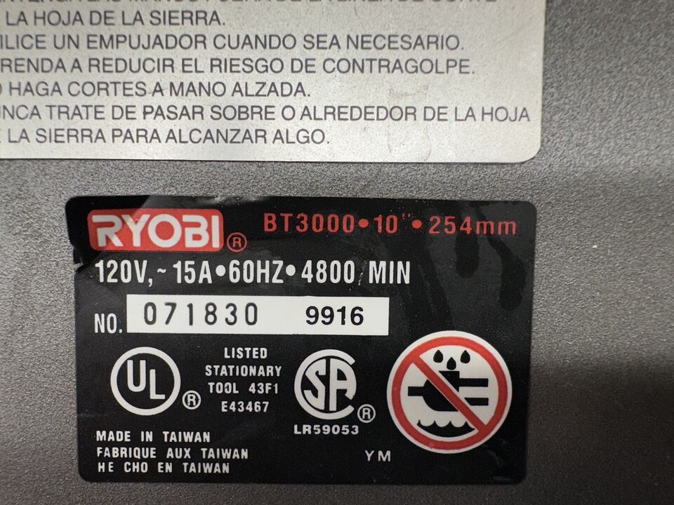

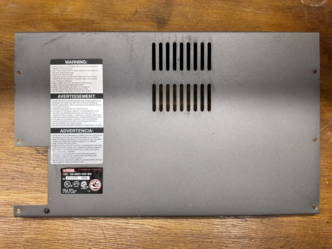

    There should be a nameplate on the Right side next to the power plug with the S/N, four digit date code of manufacture YYWW format and the voltage and Amp/RPM rating.
    Click image for larger version  Name:	image.png Views:	0 Size:	939.8 KB ID:	857502
    This example made 16th week of 1999
    The saw came out in 1991 I think, there were a flurry of changes made thru 1993 but after that is was fairly stable.
    The '92-'93 changes were power switch (double push button to safety covered rocker), upgrade of motor (13-15 amps), and the elevator hand wheel style (black metal open to black plastic closed)

      I "think" the 16 of 9916 means the "16th week" of 1999.

        Go figure- looks like the data sticker has gone missing.

          “Data”
            LCHIEN commented
            you can edit posts. I edited it for you. Admin Loring
            The saw was probably used to murder someone and cut up the body. I read criminals will file the serial number off guns so its not traceable. :-)
          • 22085
          Judging by the style of the power switch and the elevation handle, you saw is newer than 1993... they were made from 1991 to 2003 or so. Like I said the changes were few after 1993.
          The original switch had a red and green alternate action pushbuttons, green to turn on red to turn off. The later ones like yours and mine have a cover over a rocker switch... pushing anywhere on the cover turns the saw off, and you have to lift the cover to turn it on, both safety features.
          The original handwheel was black cast metal ring with a bar across the center, the two half moons created by the bar are open. The subsequent handwheel has the same diameter and black appearance but was plastic and the half moons were filled in solid, with labels indicating direction.
          As such it would also have the updated slightly more powerful motor (15A vs 13A).
          Its main weakness on the BT3000 model is the shims...the sliding bearing for the up-down motor housing height motion - they should be kept clean and lubricated with a dry lube; johnsons paste wax is the usual choice. There's lots of information about them on this site on older posts and articles.

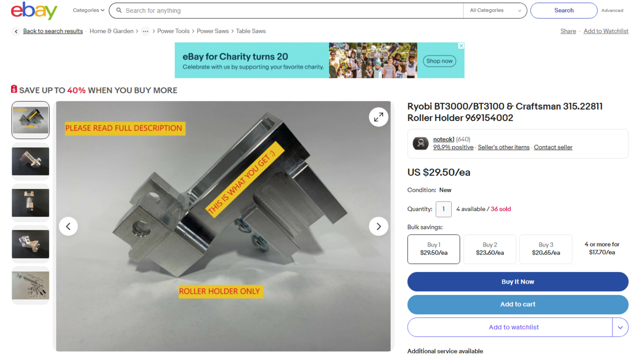

                I've read much of the FAQ, it is quite a doc. Now I'm on a hunt to fix my rip fence. upon closer inspection, its definitely been dropped. Am I remembering incorrectly?- that there was someone making those roller holders..? looking at it, it does seem like a complex piece to be made aftermarket. I'm thinking I'm going to have to buy a whole new fence when someone is parting out a saw...
                • Old Jarhead
                  • Jan 2024
                  • 10
                  • Seabrook TX
                  found one- $85!...oh boy
                  Then I found the machined aluminum ones for $49.
                  I love youtube...
                  OEM Tail Piece Assembly in excellent condition on the Rip Fence from a Ryobi BT3000 / BT3100 Table Saw. The left and right pivot pin hubs have been reamed +1/64th, the right hub fully and the left hub 3/4s, with the remainder reamed slightly less to provide a finger press fit for the pivot pin, to reduce stresses on the hubs going forward. Both pivot pin hubs are fully intact.  Roller, hook and clamp-tension screw show little to no wear. Bottom 2 nubs removed. Ships USPS Priority Mail Ships quickly, typically same or next business day.
                    • 22085
                    Don't get the used plastic OEM part, its destined to fail. See if you can find the machined aluminum ones they make.
                    Probably less than $85.
                    Here! Yeah only $29.50 and it will last forever. I have one works great.
                    https://www.ebay.com/itm/29580932232...OcAAOSwWrFf~cY w&amdata=enc%3AAQAIAAAA4GbAM8X6StAsZWvoI6Dcjvdb2 Bg xLrE7hBZXAh1dqulzsawYk2Zi0bhfq2Iir%2F4nQhWBVnqe%2F k6sX50K4ZIgQc3mHrPZnA5bQl1BC8ZU7BEc%2BzsBFiz1aPI9R uKbm8UCdg2LPgn1AByWPOi7hH0G3830EN4QOyQzLZM9id5We4v LPoM%2FTCdvjblOJ2d%2F5WL2VVuRTids4OvusBafZQPT5nTya iwlCnkViFQ5BDPMA9NQrqNTdPIqMS%2Bh1nzdOGIK7s0I0bpRx Z3MsieuourThgPBAXUAOFDkbkOwUCV2mLMm%7Ctkp%3ABk9SR4 Kn3IGeYw

                      Thats the one I found and will order
                        • 22085
                        You need undamaged roller wheel, wheel axle pin, roll pin for the clamper, and clamper from the old roller holder

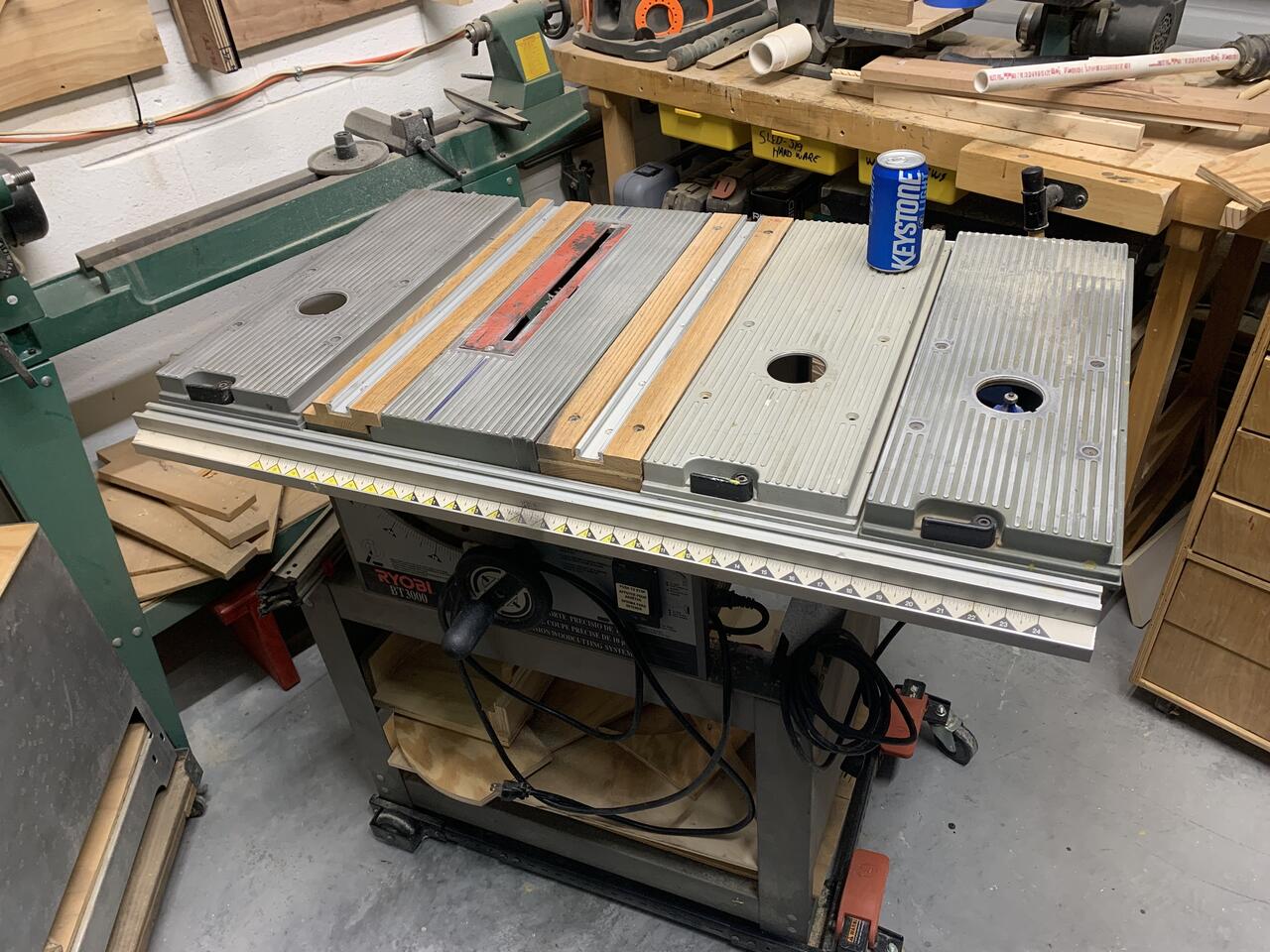

                          Welcome to the site. This is full of valuable tips,info and advice. I currently have two working saws and one parts saw. Keep a lookout on marketplace for ones that are for sale cheap. They usually run well or good for parts. Click image for larger version
