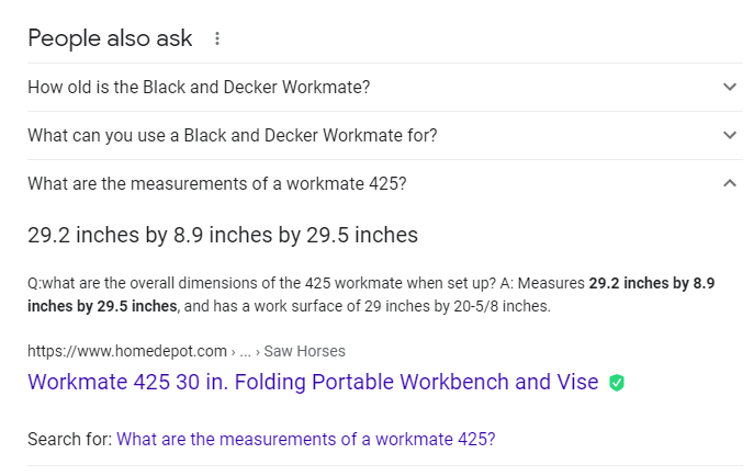

    found this on the internet
    Click image for larger version  Name:	image.png Views:	0 Size:	65.5 KB ID:	854282
