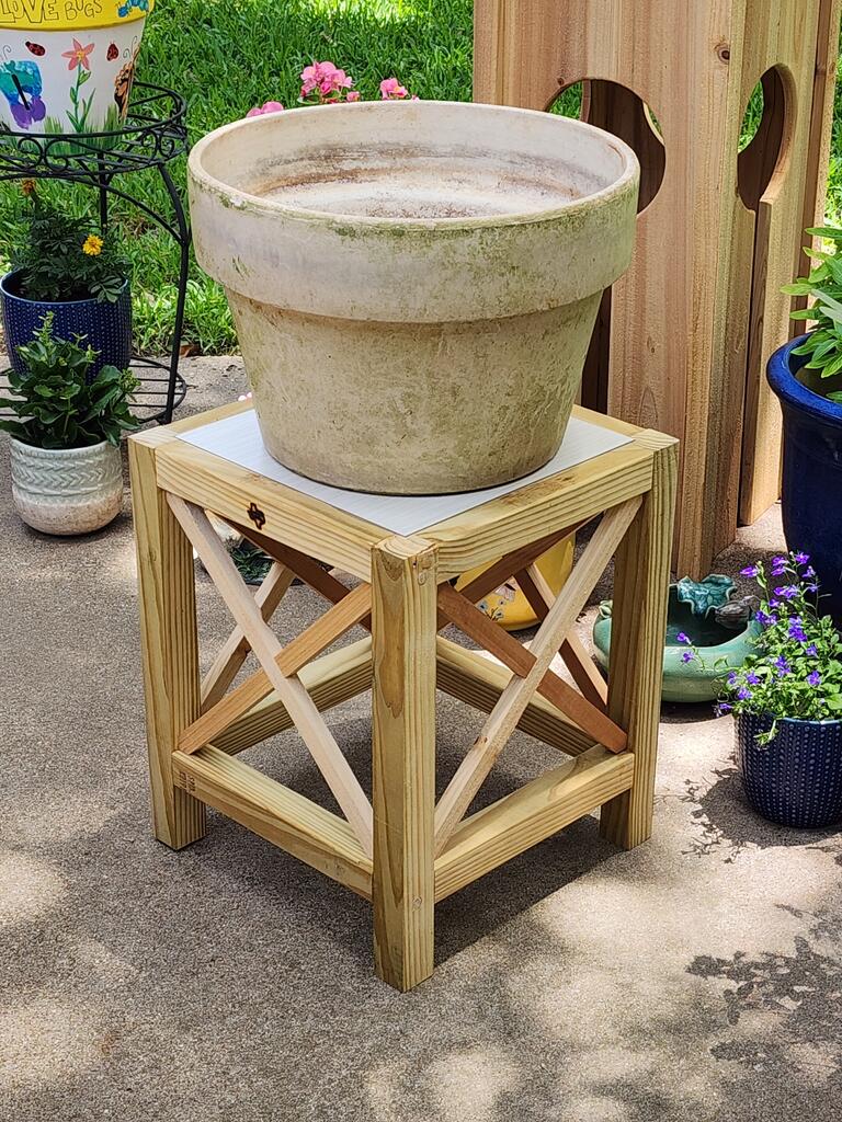

    Made another planter stand, This one from treated pine 2x4 ripped to 2x2 and using pocket screws. And a ceramic floor tile sample rabbeted into the top.

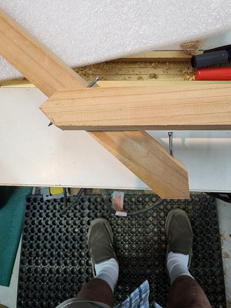

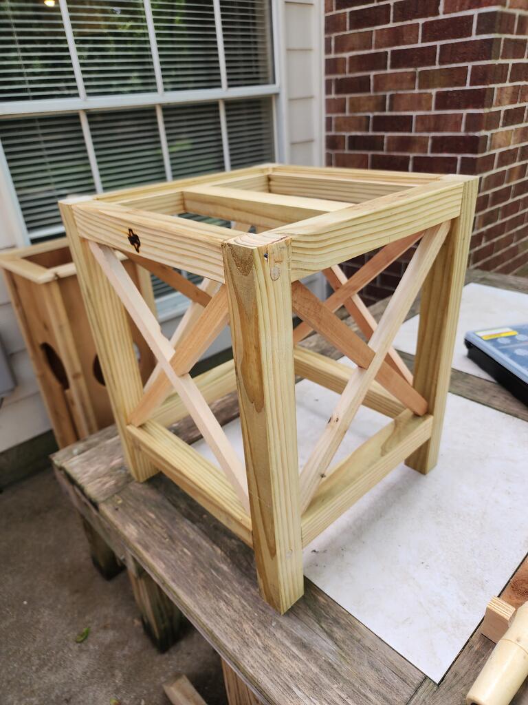

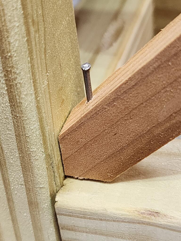

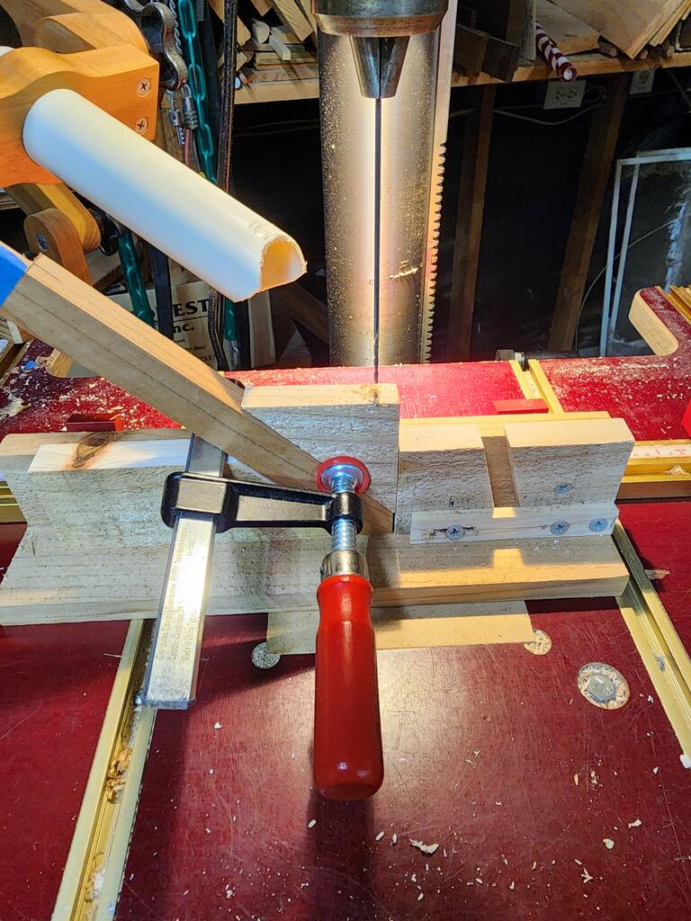

    The frame was quite strong, the braces I added for decorative reasons, from cedar strips. The frame was pretty easy, the strips proved a real bear. I half lapped the crossovers. Fastening to the frame was tough because the narrow space, closing angle to toe-nail them was impossible to get a hammer in there and the sloping wood makes entry of the nails difficult..

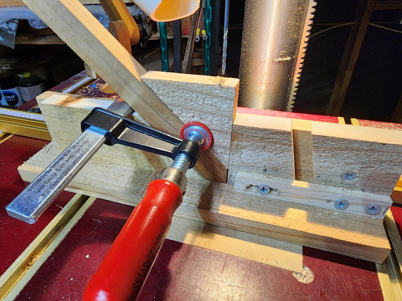

    I ended up picking a finish nail and made a drilling guide jig to make a pilot hole that held the nail. Took a 6" long 5/64" bit so a guide was necessary to keep the bit from deflecting on an angled entry.
    Click image for larger version  Name:	20240509_232042.jpg Views:	4 Size:	238.9 KB ID:	858849
    Click image for larger version  Name:	20240509_232547.jpg Views:	4 Size:	113.0 KB ID:	858848 Click image for larger version  Name:	20240509_233547.jpg Views:	4 Size:	128.7 KB ID:	858847 Click image for larger version  Name:	20240509_233555.jpg Views:	4 Size:	64.1 KB ID:	858846 Click image for larger version  Name:	20240510_114053.jpg Views:	0 Size:	110.4 KB ID:	858861

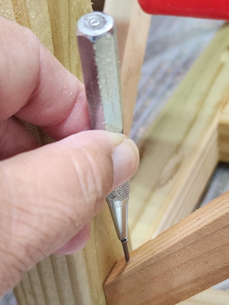

    It was still hard to nail, i used a nail set and then a longer improvised nail set from a steel rod and still ended up bending a couple of nails.
    Anyway it was an interesting experience. Next time a small screw and a long driver instead of a nail might be easier to drive in the small, narrow, limited overhead space.
