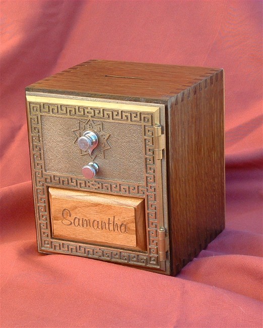

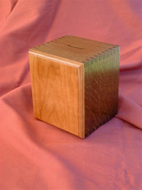

    I built this for my graddaughter's 12th birthday.
    The case is QSW, The name panel and back are Cherry. I had her name laser cut at a trophy shop. There is a shelf inside making the top a bank and the bottom a priovate hiding area. Only she and I will have the combination.
    The Cherry got a coat of Minwax Cherry stain. The QSW was fumed with ammonia overnight. Finish is 1 coat of Seal-A-Cell and 2 coats of Armour Seal.

    First time to use the Freud Box Joint set.
    That's a great looking box. Nice work. What's the story with the door? It looks like a real mailbox door.
      Sweet, Don! Excellent gift.
        you can buy the recycled doors.
        Rockler has 'em
        http://www.rockler.com/product.cfm?p...filter=mailbox
        and other places, too.

                  Thanks for the warm fuzzies! Still need to do some fine tuning on the box joint jig set up. The pins were initially too tight.
                  I picked several of them at a yard sale a while back. Most are braass, 1 or 2 are chromed. A few are the older twin dial set up. Hardest thing was finding someone around the Post Office that still knew how to work on them.

                      Very nice job Pappy! When I first saw it my thought was... how did he pull off that door front, wish I could do that! You're going to love the Freud Box Joint set I believe. I don't know what type gauge and fence set-up you have but it might require a fine tune. I fine tuned my jig with a small piece of self adhesive slick tape shimmed to the side of the register bar.
                      BTW.. you might find that with hard-wood it will be a tad tighter fit than with soft-wood so experiment with both to see what your results are...

                          How wide is the slot on top and how'd you cut it? Router?
