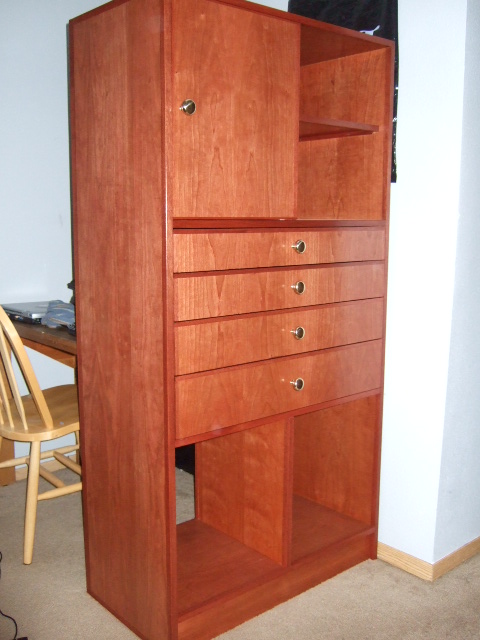

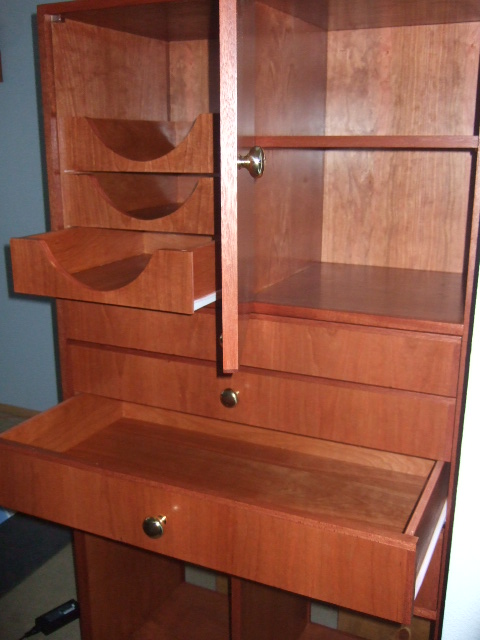

    The LOML wanted a cabinet for her scrap booking supplies and paper, stamps, cutters ect. The finished books go on the bottom shelf hopefully there will be enough room.
    The frame and drawer fronts 3/4 cherry ply trimmed in mahogany- biskets, the drawers are 1/2 inch cherry ply-air finishing nails. We wanted a darker look so I stained it with a mix of 1/3 sedonda red & 2/3 natural minwax, then several coats of wipe on poly.
    Drawer knobs were from Bargain Alert from Rockler last yr

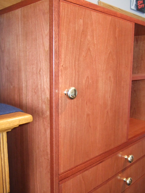

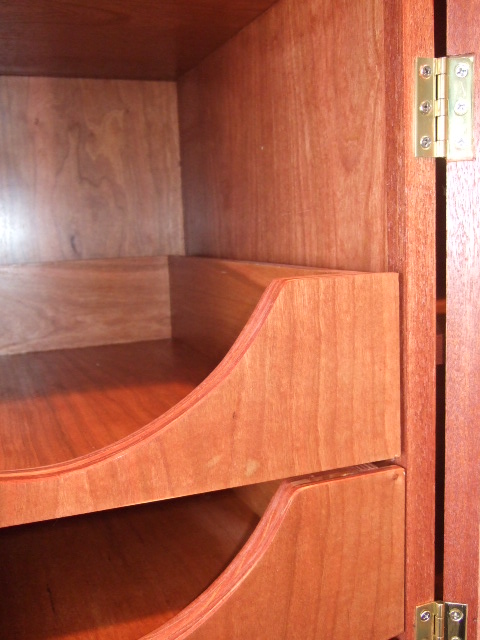

              Very nice job, J L. Seeing your drawer fronts were very timely for me also as I have to build two drawers today that will be hidden behind a cabinet door in a computer desk-hutch. I intend to use a 1/4 or 1/2 moon cut-out as you did in lieu of pulls. Yours let me know what 1/2 looks like and gives me more in-sight on which way I want to go.

                  very nice. i love the 1/2 moon cut on the drawers.

                        That is one nice looking cabinet! It looks like you even took the time to cut and place the drawer faces in series so the grain runs from top to bottom. I am impressed also with the beautiful stain and finish work. Just beautiful!

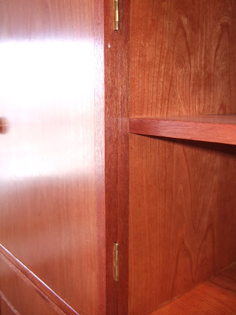

                            very nice indeed! Is there a reason that the door on top has the hinges in the middle of the piece? Not that it really makes a difference, just wondering.
                            • jlake1998
                              • 37
                              • Washington
                              Thanks everyone for the nice comments.
                              Alex, Sorry I don't have any plans. I measured her current boxes for paper and other scrapbooking items and ensured a little extra room.
