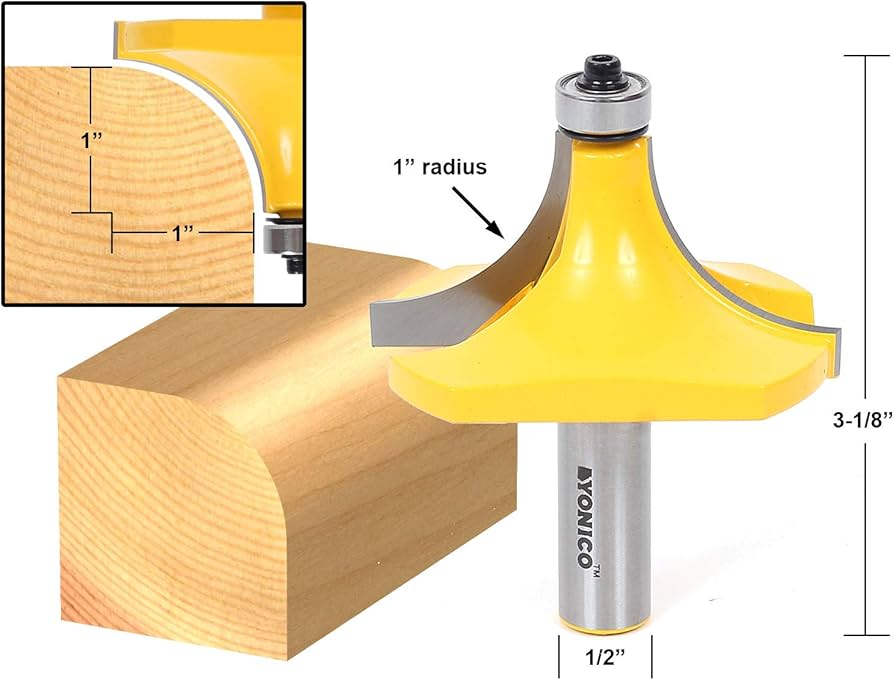

    Click image for larger version  Name:	image.png Views:	0 Size:	400.0 KB ID:	859833
    Router bit profiles all have names.
    Roundovers come in various radius; they can also be used for beading For a 2x8 on vertical edge, like a deck railing, probably a 1/4", 3/8", 1/2", or 3/4" roundover on two edges will do.
    A 1/4" roundover on both edges of a 2x8 on edge will leave a 1" wide flat; A 3/8" Roundover will leave a flat 3/4" wide, a 1/2" radius will leave a 1/2" wide. A 3/4" radius roundover on both sides of a 1-1/2" wide piece will leave zero width flat at the top, basically you have a 1-1/2" fully rounded over (180 degrees) top.
    OTOH if the 2x8 is flat horizontal, a pretty wide hand rail, then the flat area will be wider and you might want to go as much as 3/4" radius.
    All depends on how "soft" a corner you want to have on it. Construction 2x studs often come with a 1/8 to 3/16" roundover to start with.
