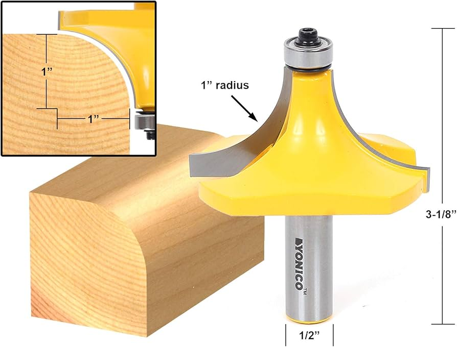

            Basically what I understand you want is this profile for the rail
            Click image for larger version  Name:	image.png Views:	0 Size:	2.6 KB ID:	860100
            There's such a thing as a bullnose bit that will do this in one cut but its hard to use because it has no easy way to reference it's bearing. And it will be kind big at 3/4" radius. 1-1/2" diameter.
            Click image for larger version  Name:	image.png Views:	0 Size:	13.3 KB ID:	860101
            The best way and a useful bit to have when you are done will take two passes is a 3/4" radius roundover bit, makes a quarter-round.
            Click image for larger version  Name:	image.png Views:	0 Size:	23.3 KB ID:	860102
            basically with one pass you get a quarter round, two passes will get you a half round which is what you want. If the wood is reasonably well dimensioned you will get a nice half round/
            I really would not do this with a router table... you'd be moving the wood which is big long, heavy piece. Hand held you'd be moving the router which in my opinion is much easier because is compact and light.
            You kind of have to make a decision to route before assembly or after assembly.
            • Before assembly can router the entire length but to make any corners look good you have to miter the corners where the rails meet.
            • After assembly you can route around butt joined corners but the downside is you can't router to within a router diameter (3 inches) of an wall or post.
            Also you have a choice of making two passes
            • rail on edge and making two passes of either side (this will work better as the bearing can ride on the side of the board) But its hard because you don't have a very wide flat surface to run the router base plate against making it easy to tilt the router and make a less than perfect cut
            • Rails lying flat, route one edge, flip over and route the opposite side. this is a little iffy because the bearing on the second cut does not have a good flat registration top sit on, but it works OK, the bearing sits on the edge of the crest of the curve. I think this is the way I would do it.
            Another thing I would consider personally,
            instead of a full 3/4" radius I would consider a 1/2" radius roundover giving 1/2 quarter round, 1/2" flat and 1/2" quarter round. Not quite so sharp to lean on for a railing top.
            or even 3/8" - radius giving 3/8" QR, 3/4" flat and 3/8" QR. It's also easier to route eliminating some of the issues I raised above.
            Click image for larger version  Name:	image.png Views:	0 Size:	12.1 KB ID:	860106
            Before carving up big pieces of 2x8, you might want to practice on foot long pieces of 2x4.
            You can choose whether you want to route the top edge or the side edge.
            Also its going to take a bit of practice to set the bit height just right.
            In the picture below, the bit depth or height makes the top curve just meet the top edge of the wood. Otherwise you just get a "bead" or a "step" not a smooth transition from the curve to the smooth/flat.
            Click image for larger version  Name:	image.png Views:	0 Size:	400.0 KB ID:	860105
