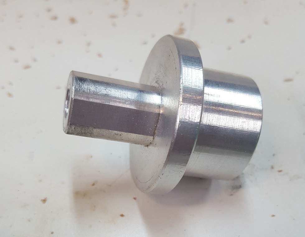

    Sometime back I bought the adapter off eBay to adapt a standard 4 or 5" handwheel with a 1/2" shaft hole to the BT3000/3100 oddball handwheel shaft. Handwheels with 4-5" and a 1/2" hole for a shaft are readily available if you look around.
    I found a handwheel at the time and connected it to my adapter. I never installed it on my BT3 because, well, it wasn't broken and I could not get the bolt free that holds the existing handwheel on. I hear its got some locktite that needs to be broken loose but I just did not feel like forcing it - you know, not broken, don't fix it.. But should I want to or need to replace it I have a nice metal one ready. I am sure a impact driver will back out that stuck bolt holding my wheel on.
    I did make a drawing of the adapter as I shamelessly reverse engineered it and it is attached below. Its not hard to make, probably a 3D printed part will be strong enough. I got a nice handwheel from Grizzly but its no longer available. The existing BT3 handwheels are 4.5" diameter, a 5" will doubtlessly work fine although at one I do recall someone saying that the rip fence locking lever locked position hit their larger handwheel crank if they were both unfortunately located (very small chance).
    Click image for larger version  Name:	BT3000 handwheel adapter.jpg Views:	0 Size:	67.7 KB ID:	850284
    Click image for larger version  Name:	20200718_114759_crop.jpg Views:	0 Size:	131.1 KB ID:	850285 Click image for larger version  Name:	20200718_114809crop.jpg Views:	0 Size:	121.7 KB ID:	850286
    Click image for larger version  Name:	20200718_114845crop.jpg Views:	0 Size:	227.4 KB ID:	850288
    Click image for larger version  Name:	20200718_115003crop.jpg Views:	0 Size:	217.4 KB ID:	850287
