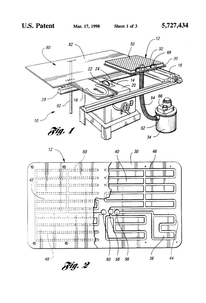

      The "air floatation table" (model number 4730320) was an accessory to be used with the wide table kit and extra leg kit. Hooked up to a Ryobi shop vac it would:
      1: mimic an air hockey table, using air blown through the top to lift large/heavy sheet goods, making it easier to maneuver them through the BT3000 saw. The air floatation table would be connected to the vacuum exhaust.
      2: when connected to a vacuum suction hose, the air would hold workpieces to the tabletop, a vacuum holding setup. I don't remember use as a downdraft sanding table being mentioned in Ryobi's flyers; I doubt the Ryobi vac had enough CFM to make this worthwhile.
      The problem with these tables when new: many shipped with non-flat tabletops; typically they had a shallow depression.

        A very interesting accessory.
        It attached to the wide table kit and table leg kit (rail and legs) to provide another 40 inches of table width for panels.
        As stated it could be used to float large panels or as a downdraft to hold panels for sanding..
        A perforated table top facilitated this.
        The table had a lever to partition the vacuum/airflow so that it hold or supported 1/4, 1/2 or the whole table width nearest the blade so you didn't waste too much air in the wrong place.
        IT was a bit thin but I think that the air cushion or suction would compensate for any sag.
        I thought it was innovative, but it did take up a lot of room,
        Here's the patent on it
        I wanted one for the longest time, did a lot of reading on it. In the end I don't do that much large panel work and I didn't have the room for it. So I never got one.
