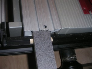

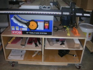

    I've got a small shop so everything is on wheels. My BT3100 is on a mobile base that I like to keep pushed up against the wall. I don't need an outfeed table all the time so I want one that takes up zero space if possible.

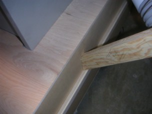

    What I did was take some scrap 3/4 melamine and cut strips 24" long and about 2" wide. I glued a piece of 1/2" birch ply cut to length and just tall enough to put the melamine a smidge below the height of the saw table. The 1/2" ply fits perfectly in the groove in the back rail.

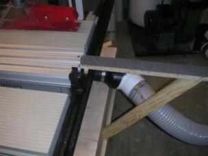

    Then I screwed/glued a brace made of scrap wood to hold up the back of the melamine. It fits into a french cleat I attached to the back of the mobile base.
    I have four of these suckers - they come off and store away when I don't need them. When I do need them they pop on and can be placed left and right where ever I need them for the width of the piece I'm cutting.
    The first pic is the front of the mobile base.
    The second is the outfeed brace as mounted to the back.
    The third is a close up of how it mounts to the rail (the 1/2 ply is longer than the brace is wide).
