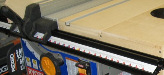

                    I have BT3100 with wide table kit. I use the scale a lot - when building the mobile base I took time to calibrate that scale and I can rely on that scale to a high degree of accuracy. I never move the rails. Even when I need to flip the saw over for maintenance - my mobile base is designed that I can flip the entire top surface with extended rails attached as one piece. When I installed a wide table kit I bought a stick-on steel scale tape from Lee Valley and extended the scale onto the second set of rails. Below is a link at Lee Valley:
                    http://www.leevalley.com/wood/page.a...=1,43513,43517
                    Alex V

                          Lee Valley sells self stick measuring tapes (made by Starrett), in both right to left and left to right configurations. I believe they sell for under $10.00 each.
                          Bruce
