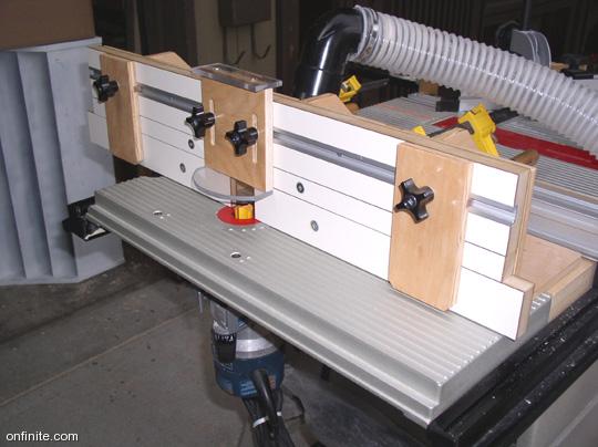

              I've posted this before, but it's a great improvement over the Ryobi fence in the accessory kit!
              2 adjustable fences, laminate covered, "T" track for attachments.
              Clamps to rip fence, uses same 2 1/2" DC hose & attachment as saw.
              It's from "Wood" magazine & fairly easy to make.
              sam :-)

                I looked at the Ryobi accessory fence and agree its not very good at all. I made a version of Jim Frye's today and it looks like it will function but its rather bulky.
                What was the deal at Sears on the fence you got?
                Is it still on clearance?
                  Sam,
                  WOW that is a serious fence!!! will you make me one??
                  Seriously do you have a link to the plans?

                        I've looked at a lot of fences, and decided on that fence when it came out in their mag a couple months ago. I am starting the build on it this week.
                        Here's a link to the plans. http://store.woodstore.net/rofe.html
