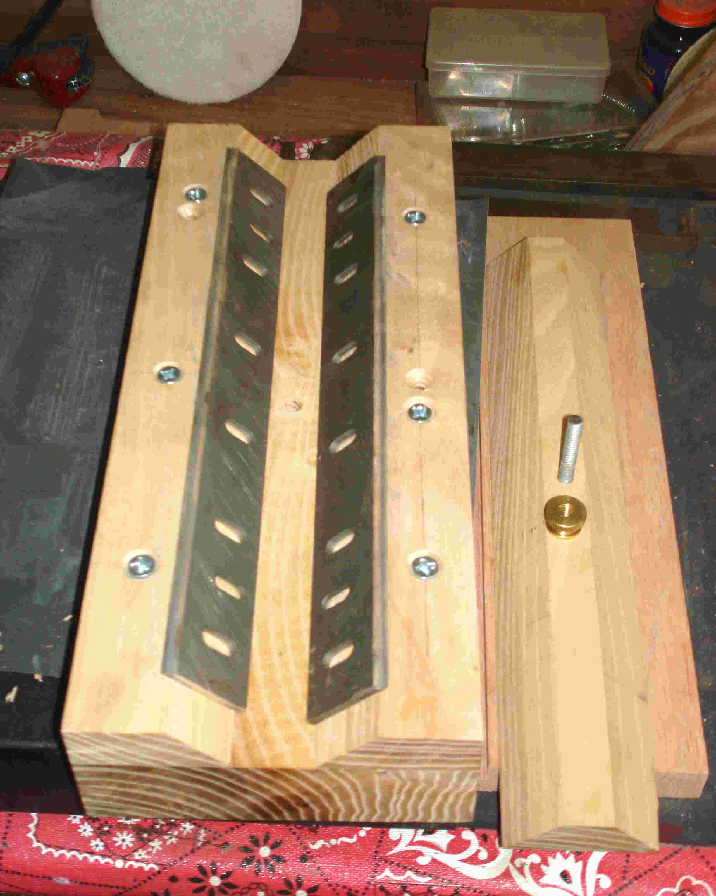

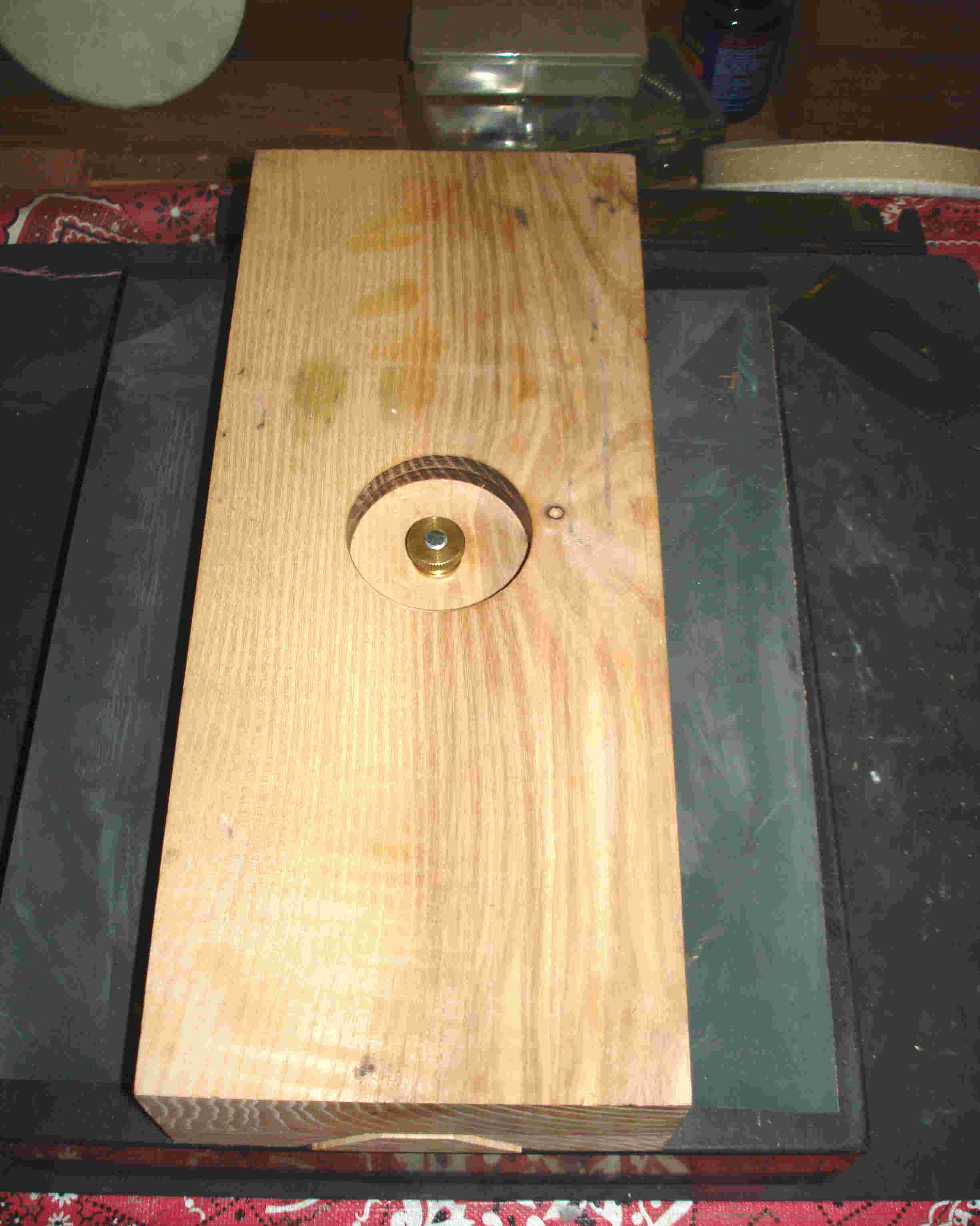

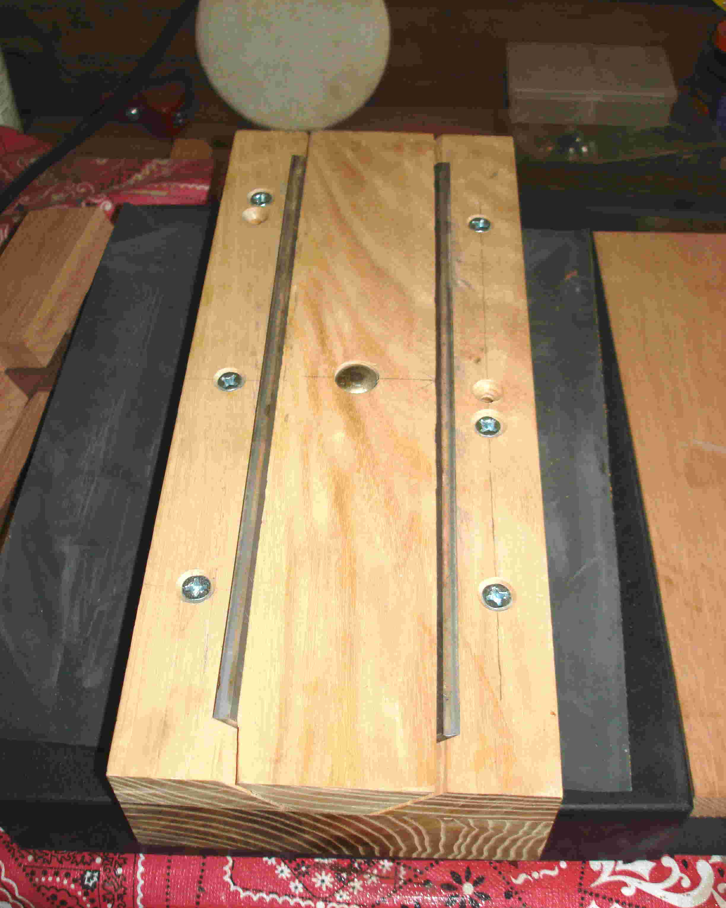

      Here is a quick idea for sharpening planer blades.
      I have an old Ryobi AP10 Planer that is still going strong. ( I wish it would die so I could buy a bigger better planer) But the cost of blades and blade sharpening was getting crazy. I have a lot of rough cut lumber to plane. So I built this simple jig for sharpening blades.
      I started with two pieces of white oak 2" x 5" x 12". One piece is the base. Cut the other at the angle of the cutting surface of the planer blade ( base about 1 7/8") reverse the the piece and cut the other side. Attach the two sides to the base. Lay the two blades in and trim the center insert so it will nor quite touch the bottom when pulled tight. Drill a center hole for a carriage bolt and counter sink the bottom with enough clearance for the nut.
      Then you can run a sharpening stone across the top or yu can turn it over and use the sandpaper on a plate to sharpen both blades.

        Thanks, shoottx. Cool jig! What angles did you settle on for the blades to lay flush?
              On the Ryobi AP10 blades appear to 45 degree. I have just sharpened 1 set of blades this way and the y came out very sharp. Havent run them on the planer yet but I am anxious to try them ion the next change. Will report on the cut after the change.
