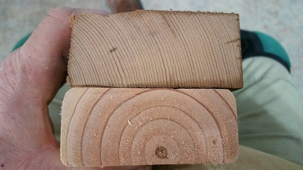

    Top is some 1905 Farmhouse 2x4
    Bottom current lumber product. Apparently a fast growing tree made for sustainable logging, it is only a few years old, compared to the old growth lumber that took hundreds of years to replace.
    What is the effect on the lumber quality?

    Given the closer growth rings, I would expect that the old one would be harder (assuming they are of the same type of tree).
    The new one certainly would be less dimensionally stable with moisture changes (the old one is rift sawn).
    What is puzzling to me is that I have found 2x4s from 70 years ago tend to be closer to an actual 2" x 4" dimension (larger than today's 1.5" x 3.5" "2x4s").. I would expect something which was about 120 years old to be even closer to an actual 2" x 4" dimension, or at least as large as the 70 year old 2x4s I have seen - yet the photo indicates both boards have roughly identical dimensions.

        That was also a question I had about that picture... how is it that the 1805 lumber is the same dimension as modern 2x4? Coincidence? Modified? 2x4 were shrunk from literally 2" x 4" finished size in the 20th century to today's 1.5x3.5 inches.
        But the original point was the relative size of the annual growth rings was astounding. Presumably the newer lumber is a result of managed forestry practice, planting fast growing trees for sustainable harvest in a handful of years (as opposed to 200 years).

          It also depends on where this lumber was harvested. My brother has an 1858 house nearby and the 2x4's are all oak and I would bet look very much like to top example and likely harvested very nearby. The bottom example also has the heart in it and the first few years of a tree's life have very rapid growth which tends to slow each year as the tree gets older. I can't tell how close to the heart the top example is, but there isn't a lot of curve to the grain.
          Also, 2x4's aren't used horizontally in framing (other than top plates with a 16" span) and their strength needs to be compressive along its length.

              Just counting it looks like there are more than 6 times as many rings per length in the old growth lumber... Means the managed lumber grows 6 times as fast.
