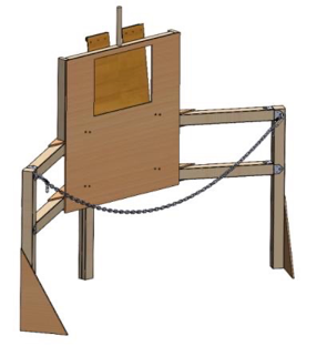

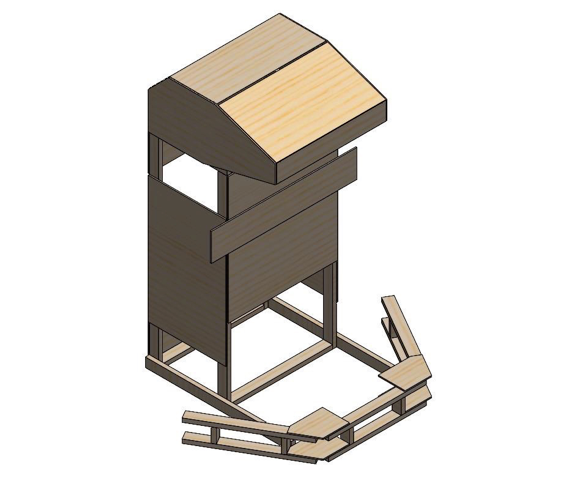

The first two pictures below are both over 8 feet high and we had to modify the design so the functional elements the robots interact with remain within 1/8" of the design, but it also has to be assembled and disassembled multiple times to get it in and out of standard doors.
The 150 pound robot needs to be able to climb onto the chain and stuff a rubber ring into the trap door on this one. It only counts if no part of the robot is in contact with the ground. There are extra points awarded if a human player throws a ring onto the post on top within 10 seconds of the robot placing the ring.
The feature below the robot has to be able to throw rings through a slot under the hood to score points This part of the robot is mostly working and they were able to hit nearly 100% up against the rail, but not so much when they were any more than a couple of feet away. This is one of the highest scoring elements so we built this first last weekend.

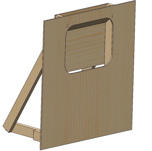

This next one the robot just needs to be able to throw or place a ring through the hole. It is about 5' high in total and didn't require any modifications for portability
