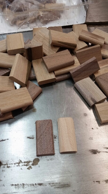

    It only took a pile of scrap headed for the firepit, 2 hours of time, $3k+ of shop equipment, and electricity for the tools, lights, and AC.
    I was nearly out of the thicker 10mm dominoes. A pack of 85 costs $24. I figure I made at least 120 new dominoes. The Festool dominoes are a tad under 1"x2"x10mm. The Domino can actually cut a 1.25" wide x 1 1/8" deep slot so I made about 3/4 of them 1.25" wide. Half of those I made the same length as the retail dominoes and the other half a little longer. I figure the upsized ones will give me a little more glue surface.
    Most of them are walnut--lots of sapwood and offcuts--and some red oak. In the foreground are a side by side of new vs retail.

    Dominos are fluted to allow glue to be presed out to the sides! If you make tight fitting dominos that do not allow glue to properly get to all sides of the domino you will soon see a structural failure of your joint!

      Before I had a Domino, I had a homemade router mortising jig. I made my own loose tenons and haven't experienced any failures. Those tenons weren't grooved. The traditional mortise and tenon joint has withstood the test of time without needing grooved tenons, too. I think my joints will be OK.

        Atgcpaul, I too make my own dominos when I need special sizes or different types of wood. I do make them where they are an easy fit, not as tight as the store bought dominos. I always coat the inside of the plundged domino hole with glue using a Q-tip and make sure that there is enough glue in the hole to squeeze out when I press the domino in. When I first started thinking about making my own dominos I did a bunch of online searches and found that others make their own, and there was concerns about glue starving. I made several tests on home made dominos, and sure enough when I used the band saw to dissect the home made domino that was a tight fit, it didn't take much effort to pry out the pieces. The looser fit home made dominos was impossible to pry out. The main comment I remember in my search was " why bother making your own, they are too cheap" I guess if you can afford Festool equipment you would probably think that way. I wish I had time to make all of mine!

          I don't like how tight the retail dominoes fit in the mortise. Sometimes I need to use pliers to pull them out after a dry fit. They all measure about 10.17mm thick. The ones I made are 0.1mm thinner and slide in and out much nicer but don't fall out on their own.
          Unless I'm gluing up a veneered panel, I think I've always applied glue to both wood surfaces--even dominoes.
          I've seen data both ways on whether dominoes are stronger than homemade, and there's a (disputed) FWW article that ranks M&T towards the top of joint strength and dominoes and biscuits towards the bottom. Whatever. Still plenty strong for what I'm doing.
