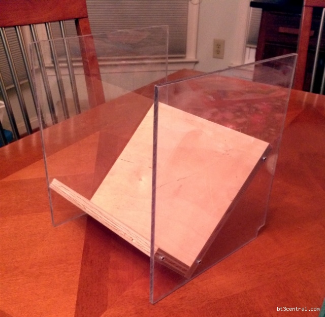

    Whipped up one of these tonight. Measures 9" tall, 7 3/4" deep, and 7 1/4" between the two clear uprights.

    Cookbook/tablet stand for kitchen?
    ...or maybe not. At first glance I thought there was plexiglass in front, too.

      I could see using this as a counter-top book rack. Actually it looks nice enough for me to think about copy it for that same purpose.
      But waiting for the reveal - what you made it for...

        Really cool spline jig?

          My first though was a coockbook display holder but it doesn't look wide enough to hold an open book and the ends are in the way. So my best guess is a book shelf for cook books for the kitchen.

              A display rack for your first ever solved Rubik's cube?

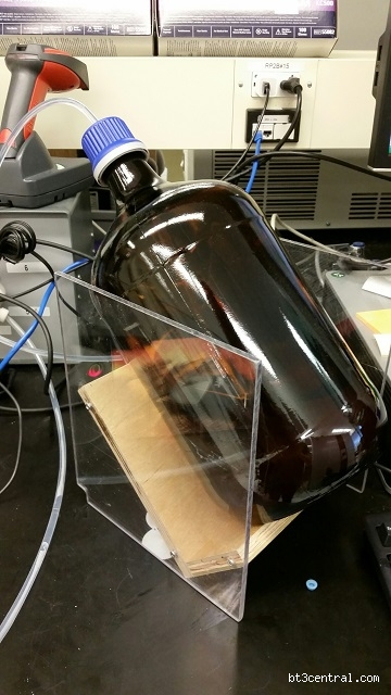

                I guess it could be a countertop bookshelf, but it's not.
                It's used to cradle 4L reagent bottles at an angle in my lab. There is a length of tubing that enters through the blue bottle cap and sits at the very bottom of the bottle. This helps minimize the risk of running the tubing dry. On the other end of the tubing is a machine that fills the reagent into sample wells.
                Before I made the cradle, we'd prop the bottle at an angle against a box. After it slipped a couple of times (one time shattering the bottle) and always spilling reagent everywhere (one bottle costs $400) and causing a huge mess, I started making these. The clear sides let us monitor the reagent level. The first one had just one clear side because it is against a wall.
                Below is a short video of what the reagent is used for. The system first rinses and flushes the black metal probe tips, then syringes draw up a custom amount of reagent. The black probes then pierce through the red rubber septum caps and dispense the reagent. The beige racks holding the red capped tubes sit under a metal frame that prevents the tubes from being pulled up as the probes withdraw from the tubes. The black probes are about 1mm in diameter. They are actually double walled. The inner tubing does the dispensing. The outer wall has 2 small holes bored in it about 1cm above the tip and that tubing is connected to the silver colored side ports. When the probe dispenses solution, air pressure is allowed to vent through the side port since the septum makes a perfect seal around the probe. If this didn't happen, the caps would pop off and the tubes would be hard to slide out from the frame--plus it would make a mess.

                    WHat looks like a dining table is a red herring! That it's used in the lab at work is not evident.
                    But the clear sides make it easy to mark where the holes to the angled-shelf need to be instead of blind!
