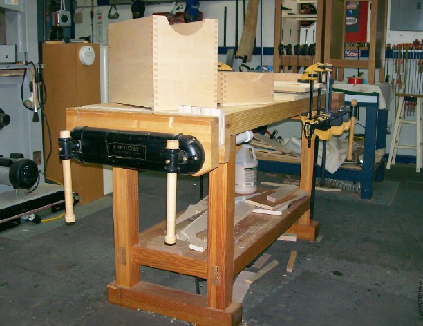

        #33
        Dour fir should be fine on top and makes an excellent base. I recovered several old 10" x 12" beams from an old civil war era warehouse being torn down in Atlanta years ago. Over 100 years after they were placed there the DF was straight as an arrow and tight, straight grain for the most part. Old growth DF was that way. The stuff being cut now is not allowed to age as back then so it does not get as large.
        Demand has dictated that but.. I have seen some really good and well kiln dried at my local HD and I grab some on occasion to keep for the next base I build...
        Good luck...
