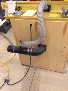

    Dust Collection: Very good
    The fence comes with a stepped dust collection port which can be cut to fit your DC setup. I cut mine all the way down and connected a 2.5 inch hose to it. Coupled with the under table dust collection, it hands down beats any other router table I’ve used. When used with the fence, the vast majority of dust and chips are picked up although some are left in the router cavity in the table. That’s probably more a function of my cabinet design than the router table itself. When used without the fence using my dovetail jig I probably collect about 80 percent and it is still a bit of a mess to clean up when done.
