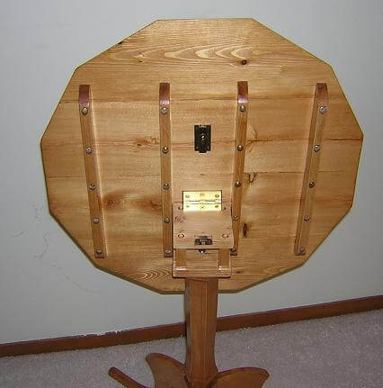

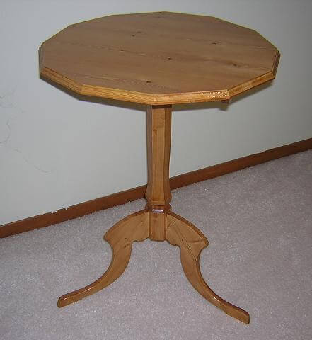

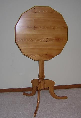

    Tilt-Top Table: The solid top is a twelve sided shape measuring 21 across and 5/8 thick. It is able to both rotate and tilt (for storage/display) by means of a birdcage which sits on top of the column. The underside of the top has been reinforced with cleats to ensure it stays flat. The column is six sided, hollow and has been profiled with a band saw. The feet are 5/8 thick and attach to the column with sliding dovetails. The finish is Minwax Cherry stain, topped with 6 wiped on coats of semi-gloss polyurethane thinned 50% with naphtha.
