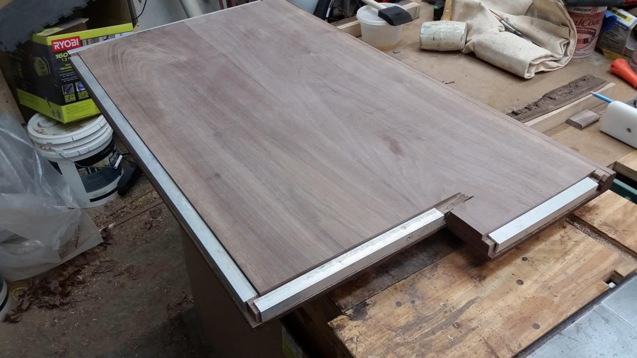

                        I went with the Dewalt track saw. I like it and since I have not tried any of the other track saws that pivot downwards, I have not experienced the "awkwardness" of the plunge action that you'll read about in many track saw reviews. So far the main weakness of the Dewalt is the depth setting. I haven't bothered to figure it out, but the depth setting dial doesn't actually tell you how far down the blade will plunge. At least I don't think it does. I don't think the gauge takes into account the thickness of the track.
                        With that being said, I recently had to make an interesting cut with the track saw. This is the bottom of a vanity desktop that will sit between a wall and a new vanity I made. I have already scribed the desk to fit into that space so really none of those edges is 90deg or parallel to other edges. I wanted the desktop to appear to "float" in that space so I'm using angled aluminum (which I had) to support the desktop. I used a dado blade to form a lip and rabbet on the perimeter for the aluminum to sit but there was one tricky section I didn't want to cut on the TS because it didn't seem safe. I suppose I could have used a router, too, but I find the tracksaw more natural for me. So I incrementally nibbled away a groove for that aluminum angle to sit. It took really no time to do.

                          i"ve never used the depth setting to do something like that dado but seems to indicate depth below the track on mine. Maybe it is a little crude but if I set it an eighth over the wood thickness I go through and about an eighth into the backer.
