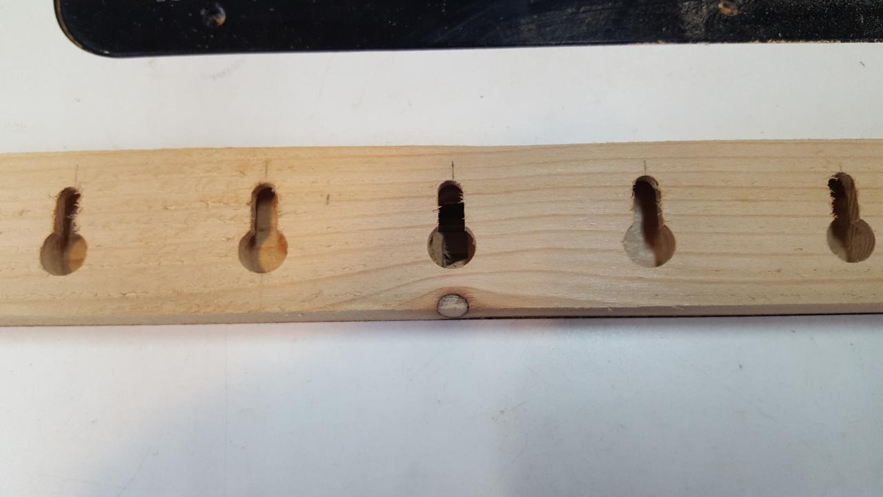

      Here are a couple of pictures of one planter I made. On the back side I routed two keyhole holes with a keyhole bit. How can I ensure the both holes are aligned perfectly to each other so as to not have the planter uneven once hanged? As one can see, the planter tilts to the right because the holes were uneven.

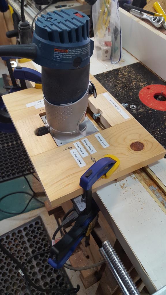

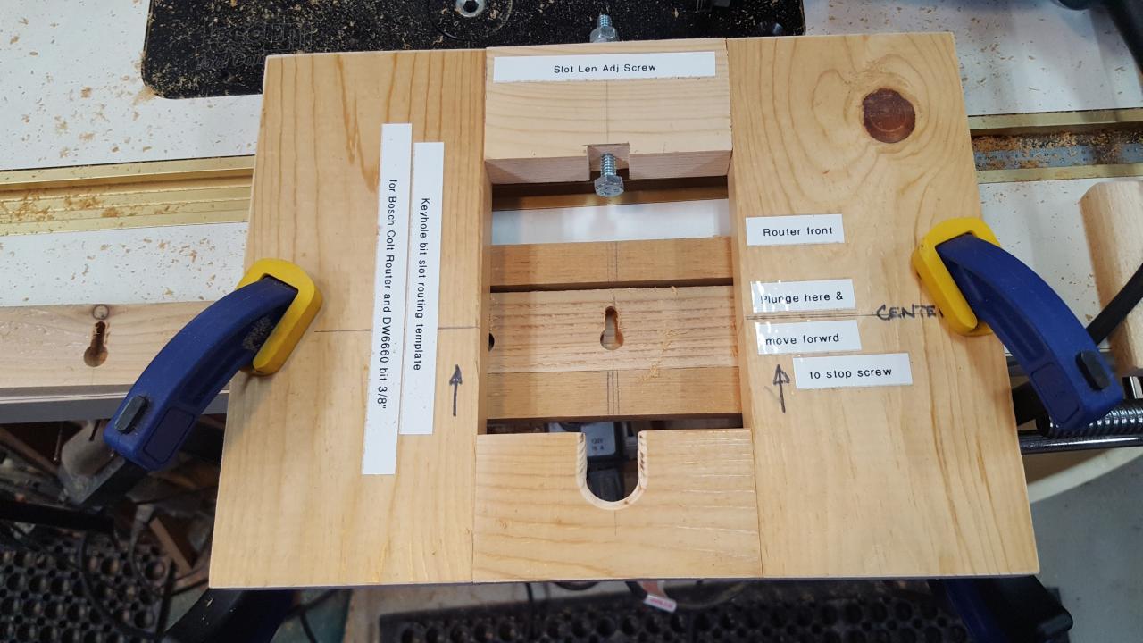

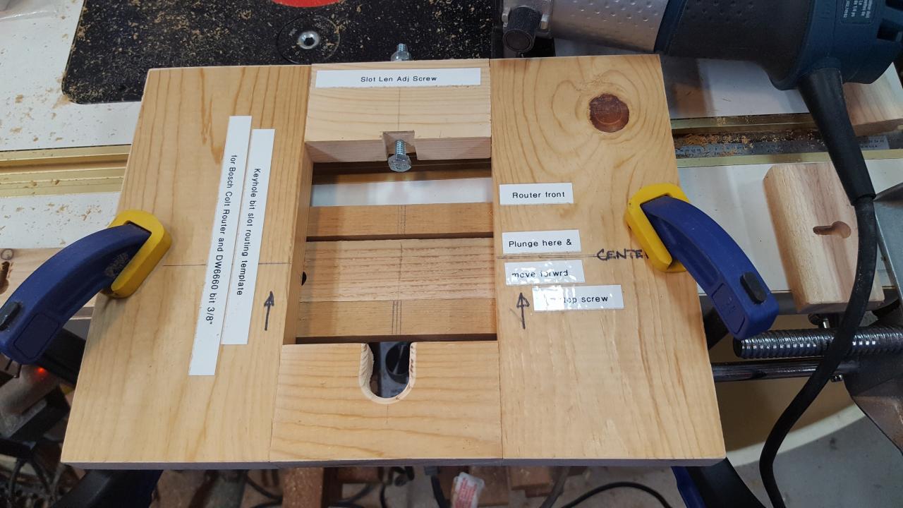

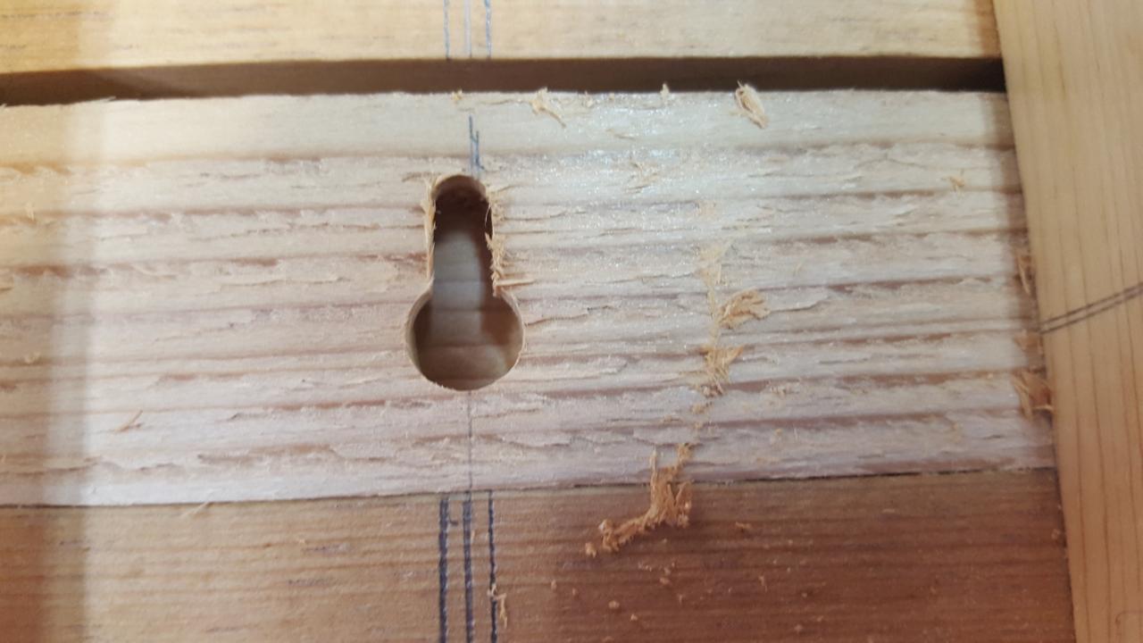

                          A couple of years late, but I just solved this problem. This will make perfectly aligned keyholes. I make them an even number of inches apart.
                          Then I take a piece of scrap lumber and drill 1/16th inch holes exactly that far apart to make a template for the new owner. All he has to do is hold the template against the wall with a level and then use a nail to mark the two places for screws. I put a keyhole in the template to test the screw depth, even.
                          https://www.sawdustzone.org/forum/di...u-made-part-ii
                          See Post #6 in the thread.
                          Click image for larger version  Name:	20200830_094442_resized.jpg Views:	14 Size:	61.0 KB ID:	840497
                          You can click on the attachments to see the entire solution.
