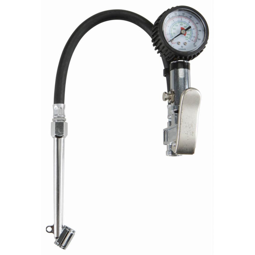

                          I have that HF chuck and in some ways its great - the dual head allows me to get to my car tires more easily even if they are upside down. The rubber outer casing for the gauge protects it from the driveway as you sling the hose around.
                          My main complaint is that the gauge has 220 PSI full scale which gives me very low resolution when filling car tires at 30 to 33 PSI range or ( but adequate for bicycle tires at 72 to 80 PSI.) Sure wish it had 110 PSI range instead of 220 PSI!
                            I find some sort of gauge on the hose to be a big help, even when it's crude and not terribly accurate. I use my better gauge after getting to the desired pressure or a little more. My 12V compressor doesn't give me a very accurate pressure but it reads consistently close to 5 psi low so I know how to compensate.
