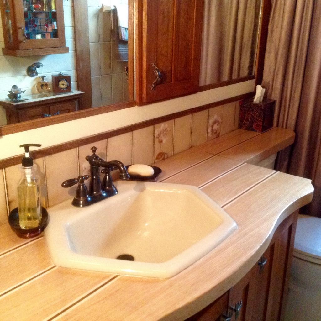

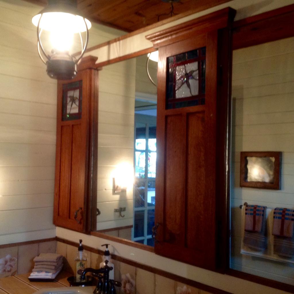

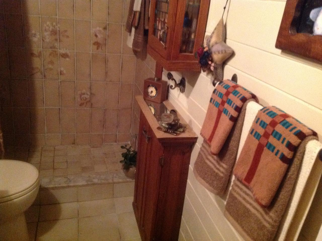

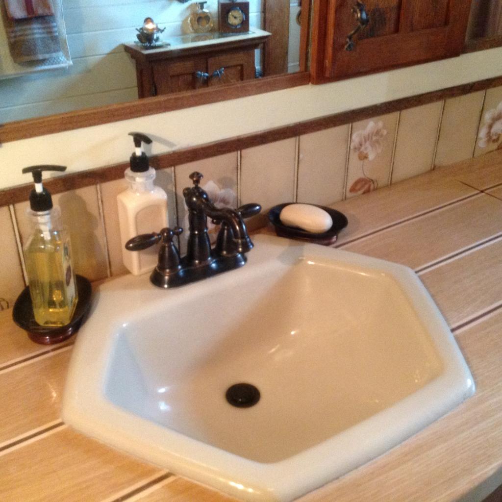

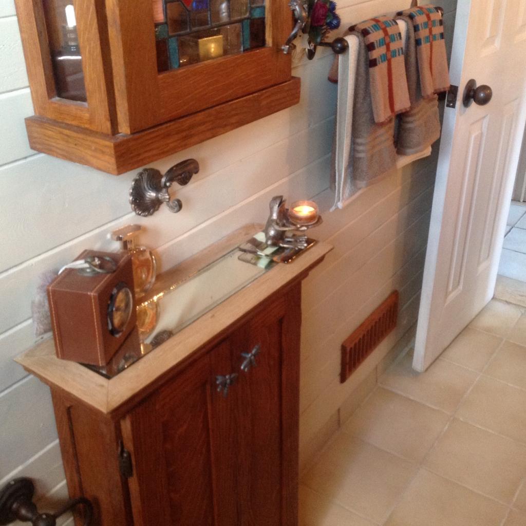

    Everything was made by us about seven years ago. Vanity, counter top medicine cabs,
    cabinets across from the toilet.

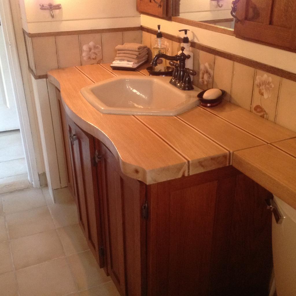

    All we did was paint the dark cedar walls white, strip the wood countertop and leave it
    natural, and replace the toilet. The sink is a Thirty year old Kohler sink in excellent condition.
    We originally stained the counter dark to match the cabs. After stripping we left it natural, and
    just applied five coats of poly.
    It went from dark and dreary to light and cheery.

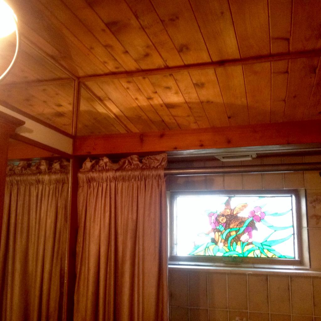

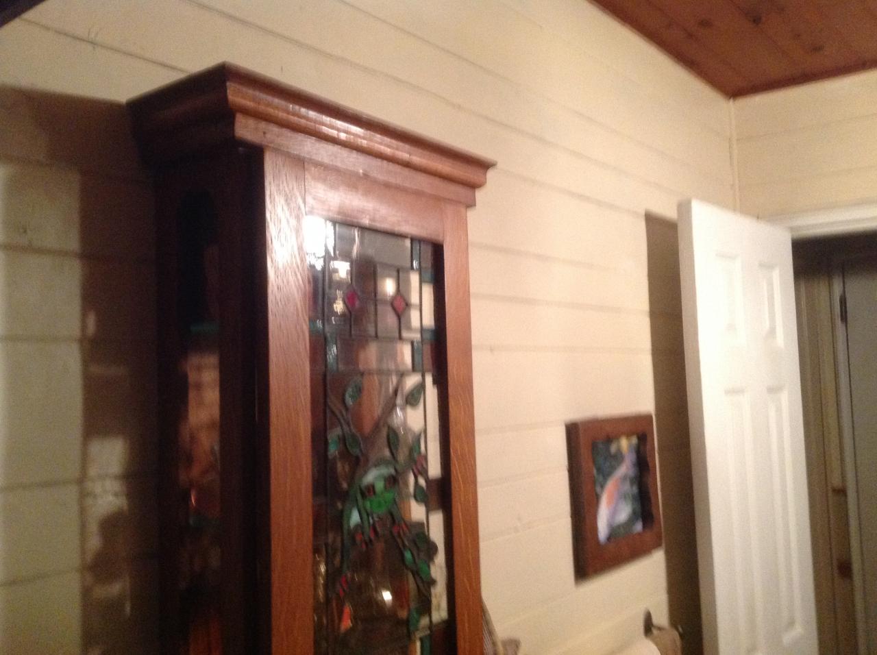

    The cedar walls and tiles we did in 1985. We left the natural cedar ceiling, just painted all the walls.
    • Two Much
      • 365
      • Long Island, NY
      • (two) Ryobe BT-3's

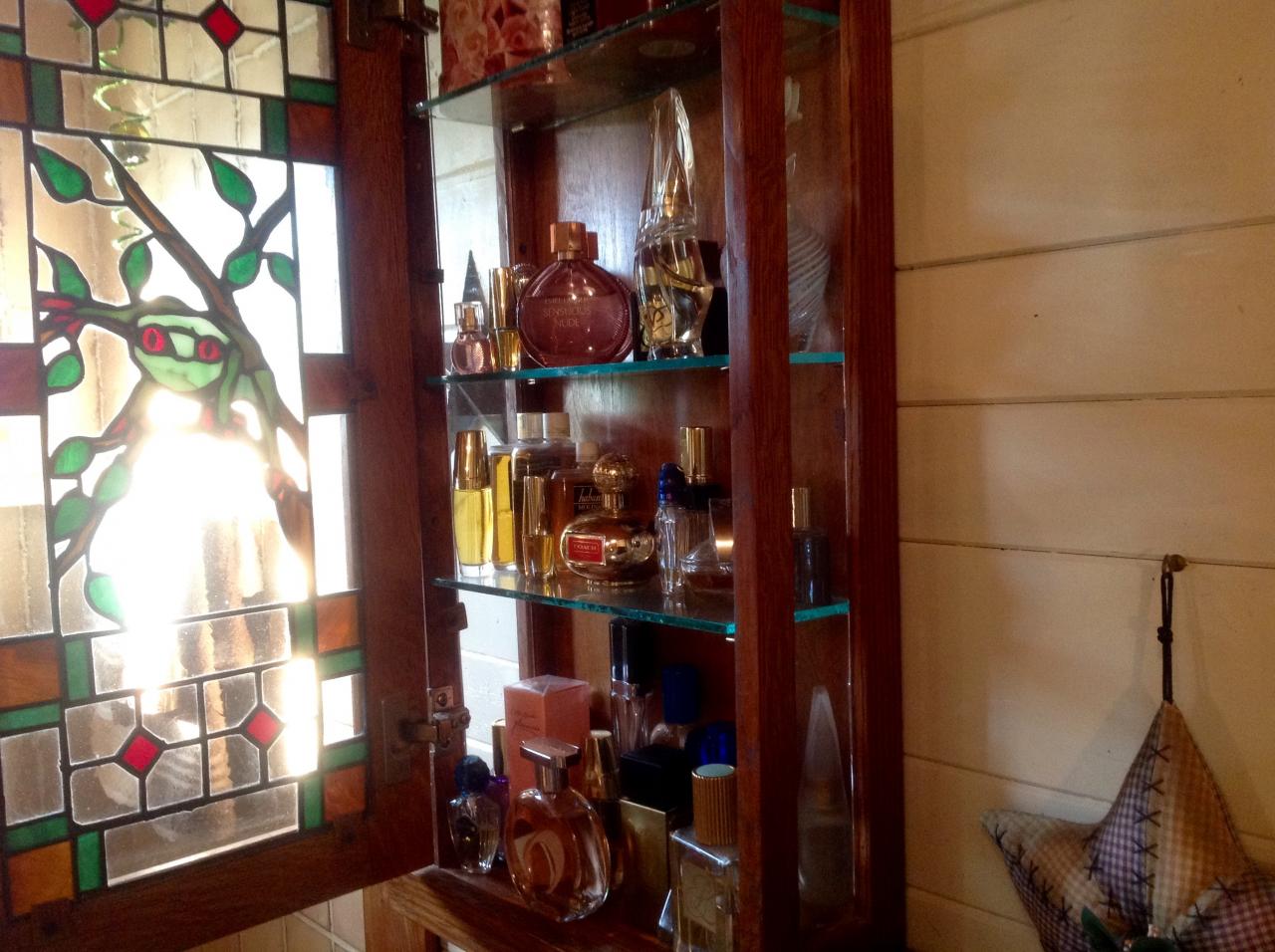

      glass shelves in cabs... There is a mirror above the shower, that why the cedar planking on the ceiling
      seems to keep going.

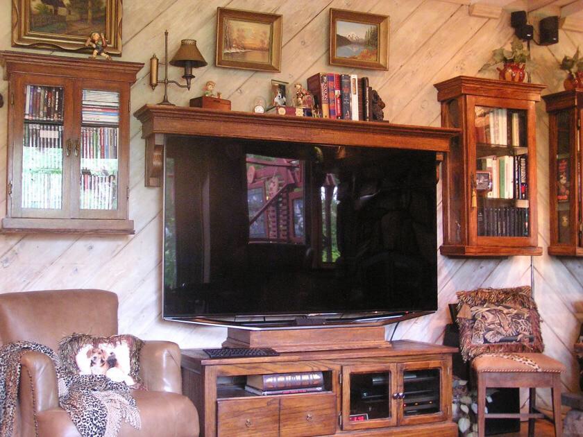

            JR. First we speckled in several knots, then did two coats of eggshell paint.
            We originally planned to white wash it like we did our family room, but I changed
            my mind and decided I wanted it solid.
            What rooms in the house you're looking at has cedar?
            I'll get pics of our family room that we whitewashed about eighteen years ago.
            Since then we only rewashed it once. It holds up very well.
            We put regular eggshell paint into a bucket and added water...then wiped it on with a rag.
            it was very forgiving; if it was too heavily applied in some areas, we washed it off with
            clean rags and hot water then reapplied it.
            • Two Much
              • 365
              • Long Island, NY

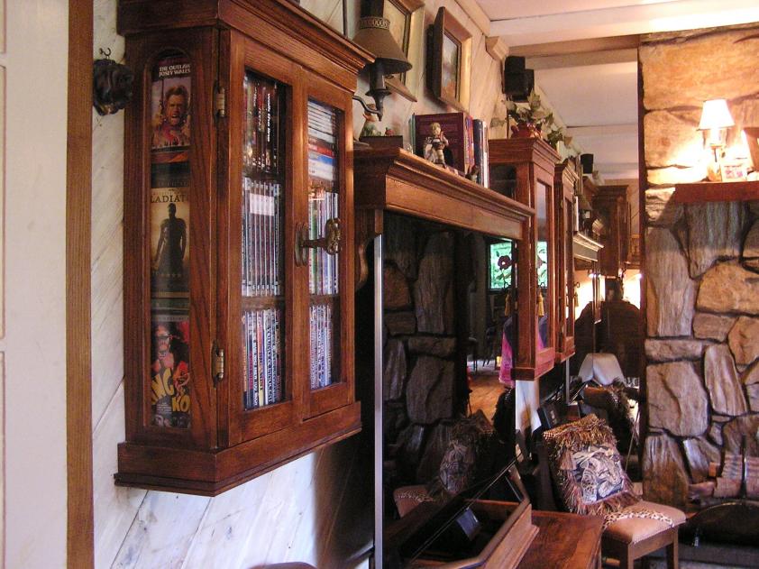

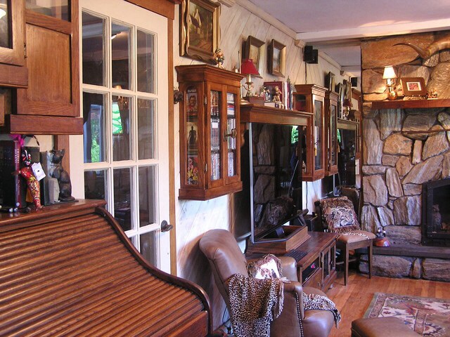

              This is the family room cedar. The pics I wanted to post, won't post for some reason.
