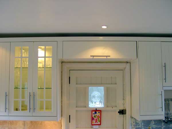

          Very nice Ray! Are you going to put some crown molding around the tops of the cabinets or leave the gap there? Kind of an interesting look, but might trap a lot of dust.
              Crown moulding has never been as popular here and is currently completely out of fashion. The IKEA wall units are fairly basic, but this package included the optional trim panels (for exposed vertical sides) and cornice moulding (as fitted above and below the cabinets in the picture below). Flash photograpy has accentuated the effect - without the dark shadow, it's much more pleasing.
              The vertical trim panels make the cabinet doors appear to be inset, but they are, in fact, full overlays on European hinges. The trim panels extend below the cabinets to enclose the cornice. The upper cornice is fixed "upside down" to mirror the lower.
              The cabinets were ordered because of their increased height, but if set high enough to close the gap above the cornice, they become less user-friendly due to shelf height. It's pretty much the basic design flavor in the UK at the moment - which is why I prefer to make my own.
