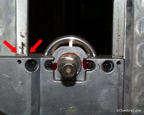

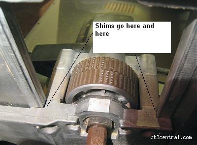

                Eric, the key to number 2 in my list is a physical exam. I will try and find a picture and add to this post. You can look and verify that the shims are in fact, intact. You will need a #2 phillips screwdriver to remove the red throat plate.
                The below picture shows a somewhat rusty and partially disassembled BT3000, showing the motor and arbor mounted to a bracket. The bracket slides up and down the vertical ways to elevate the blade. The caption show "shims go here" but there are no shims, which each would be visible as a piece of metal wrapped around two sides of the ways and serving as the sliding surface. The top and bottom would have the shims bent over the motor bracket by about 1/16th of an inch to retain them. The common failure is for the shims to stick to the ways and the retaining bends get flattened out and when the motor bracket is lowered or raised, they will fall off. Then the raising and lowering is stiff and not smooth. Fixing it takes the inexpensive shims and some work to disassemble the saw and reassemble it, not something i'd want to do on a saw i just got.
                I'm looking for a picture with the shims intact.
                Here's one at a slightly different angle. You can see the top of the shims, the ears are bent over the top of the motor bracket on both sides.
                When you take off the throat plate you can see the motor bracket behind the blade and you will be looking down on it more than from the side as there pictures were taken. If it looks like this then your saw is OK. the pics above have the blade off the arbor but you should be able to see the shims behind the mounted blade, easily.
