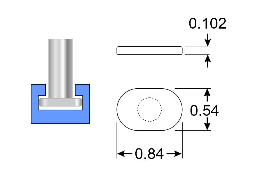

                        • 2737
                        Here's a quick sketch with some dimensions of one of my 5/16" T-bolts that were part of the kit. Hopefully this will answer any questions about "fit".
                        The "universal" T-track is also shown in cross-section. That dimension is 3/4" wide by 1/2" high, outside dimensions. Rockler sells these as a "17-pc T-track kit".
                          [ATTACH=CONFIG]22801[/ATTACH]
                          I hope this helps,
                          Thanks so much! That helps a lot!!! I really appreciate you taking the time to do that!
                          I just saw this after getting off the phone with Lee Valley. Customer service was great. The lady told me that the base of their 5/16" t-bolts is 1/2" and the length is 13/16". Lines right up with your measurements.
                          I'll put the calipers to my Incra track when I get home this evening (or maybe just try to look it up in the meantime). Thanks again!
